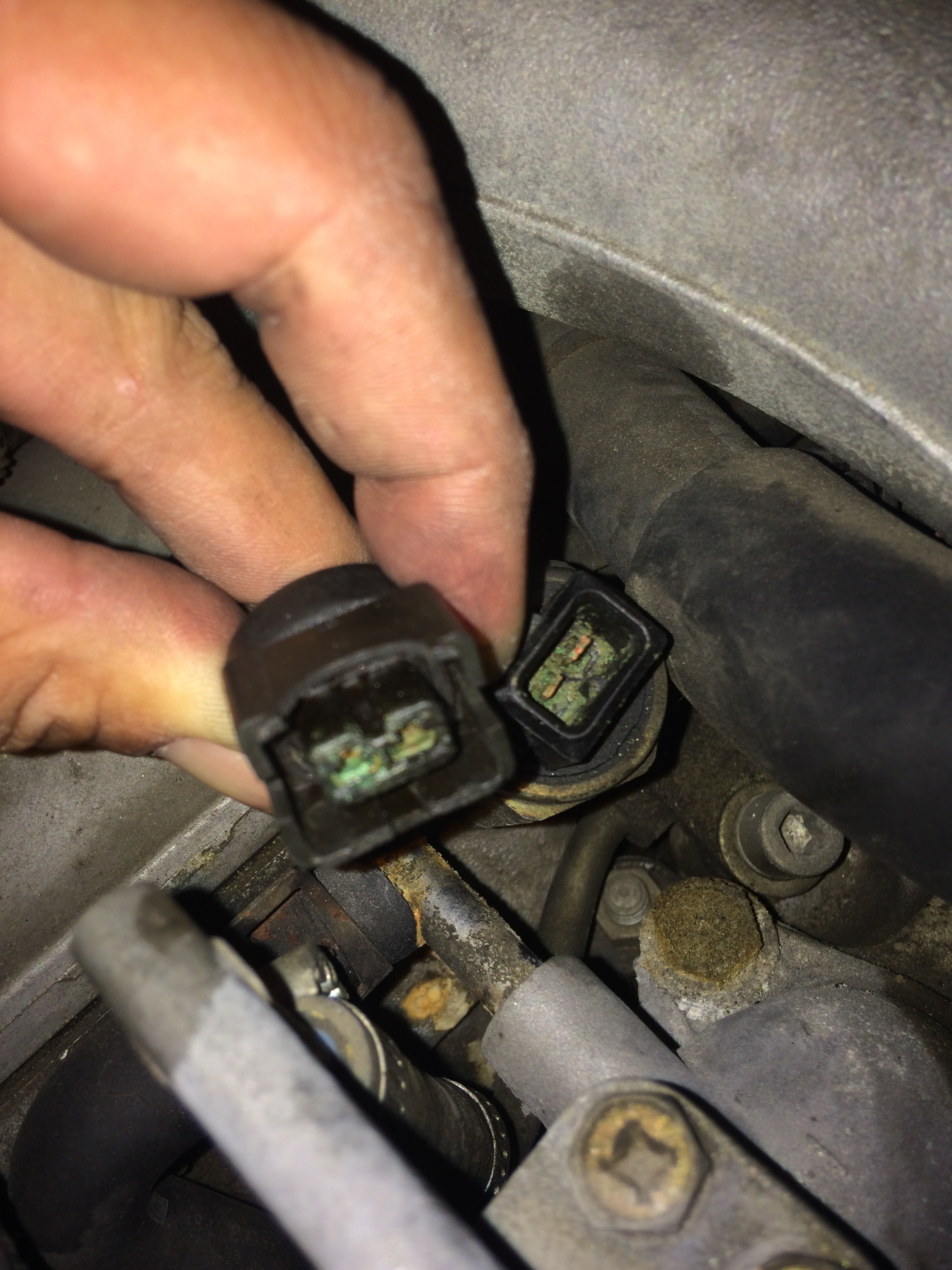

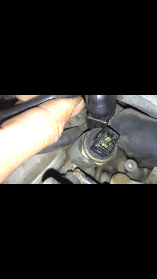

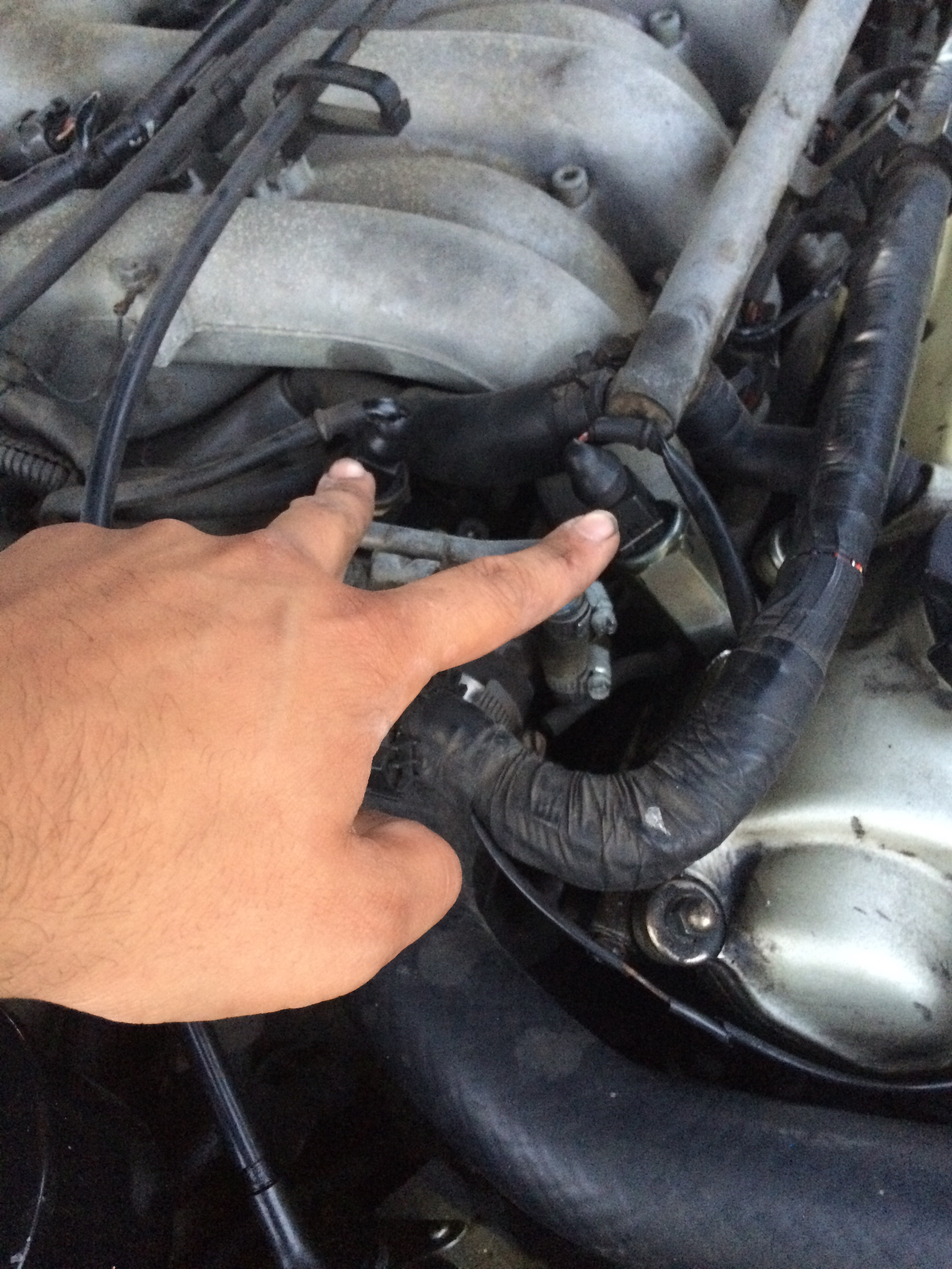

Help! I brought it to a parking lot to do as I was told I turned on the car and unplugged all of them one by one and they're all messed up okay but here's my problem now that I'm turning on the car it doesn't stay on! Help me
Old Apr 28, 2016 | 07:35 PM
  #65
Jskates420's Avatar
Joined: Aug 2013
Posts: 63
I also unplugged both of those now the car doesn't stay on!!!!Attachment 8776
Old Apr 28, 2016 | 07:36 PM
  #66
Jskates420's Avatar
Joined: Aug 2013
Posts: 63

I'm thinking it's the same thing as tonyjrs because with that plug off it stays on but when it had it on I had to rev the engine so it can stay on and also like he said a peace of that broke off so it doesn't stay in place Noob with a new 94 Maxima-photo599.jpg
Old Apr 28, 2016 | 08:34 PM
  #68
Jskates420's Avatar
Joined: Aug 2013
Posts: 63
I came to the conclusion that they're bad relays you can tell how corroded it looks,I'm waiting on my friend(the one who told me it was my head blown) at a park parking lot and see if he can help in any way I just want to go home now lol

There's no way ALL of your coil packs are bad.
No those aren't relays, those are your VTC solenoids. Why in the world are you unplugging them? You have a bunch of oxidation in there you need to clean out. You can use some white vinegar to do so.
What are you talking about putting a fuse back in? What fuse did you pull out?
Not sure what to make of your video. Are you revving it? Or is it doing that on its own? I see you have a CEL too. You need to check the ECU code(s) for that.

Old Apr 28, 2016 | 10:20 PM
  #79
Jskates420's Avatar
Joined: Aug 2013
Posts: 63
I doubt these are solenoids huh? Well this is what I meant by plugging in and out the "fuse"
