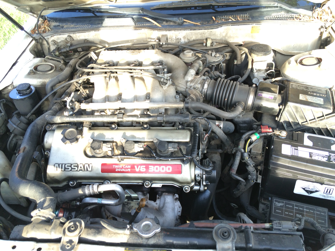

Old Apr 22, 2016 | 06:20 PM
Jskates420's Avatar
Joined: Aug 2013
Posts: 63
