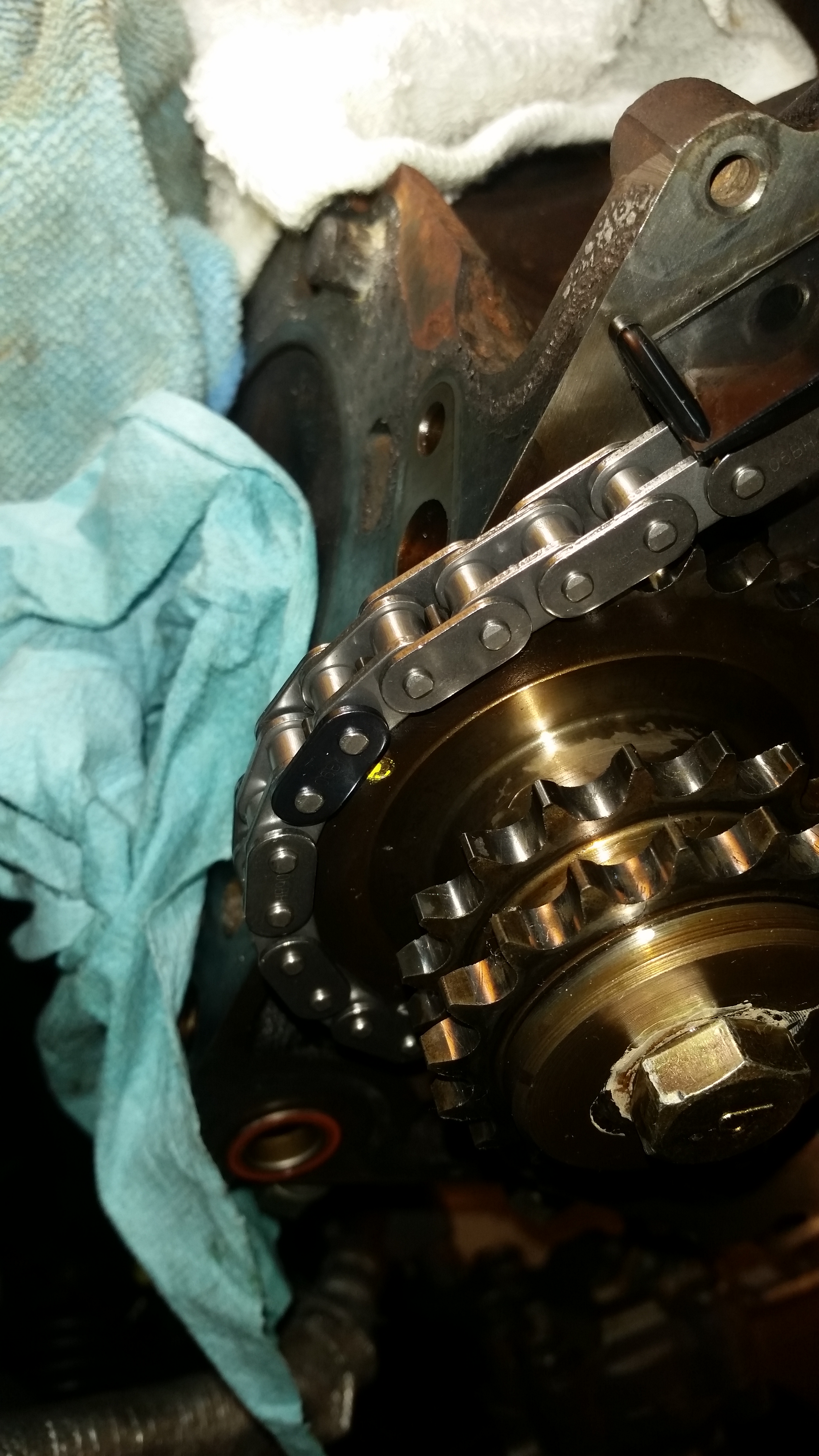

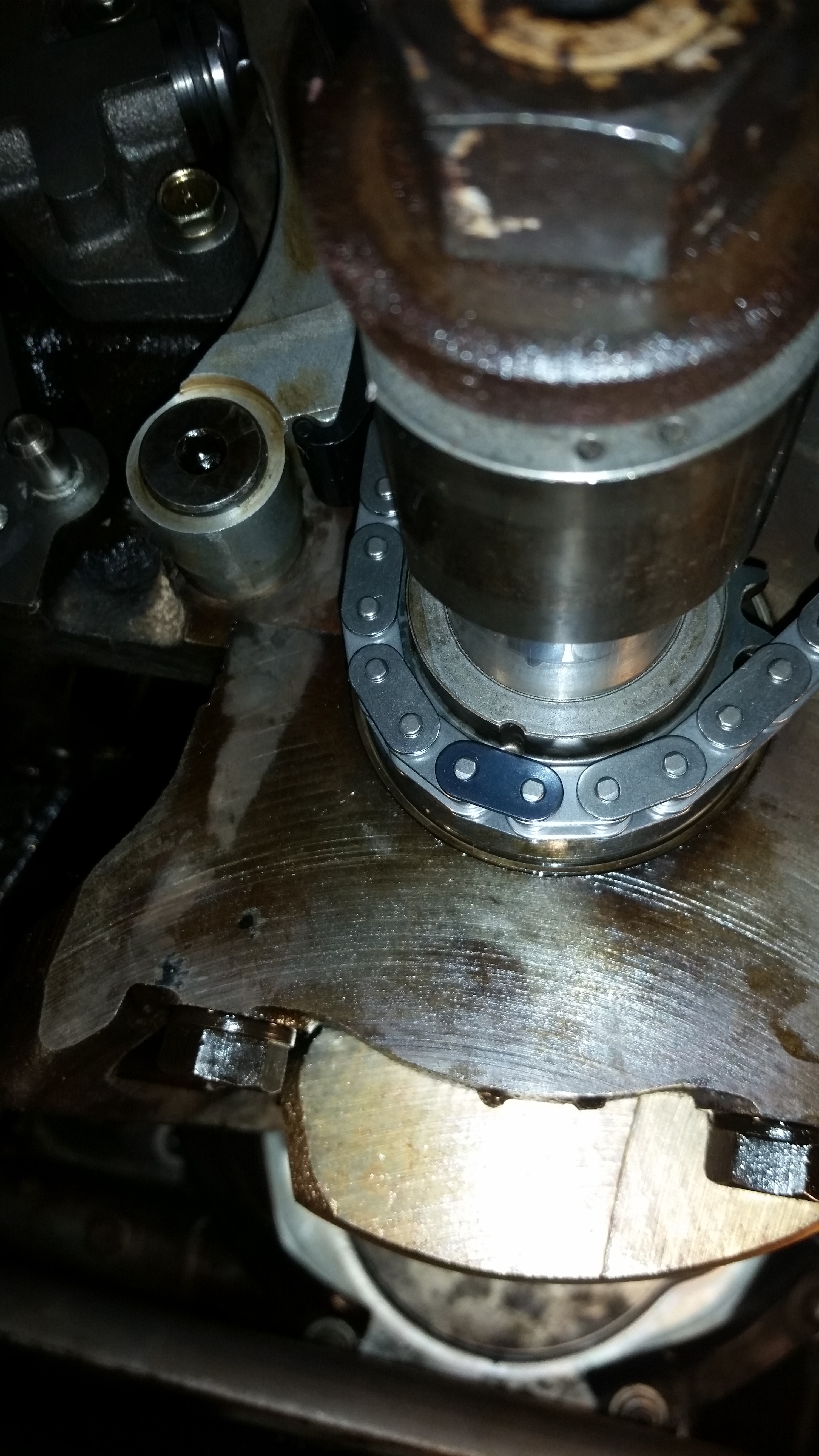

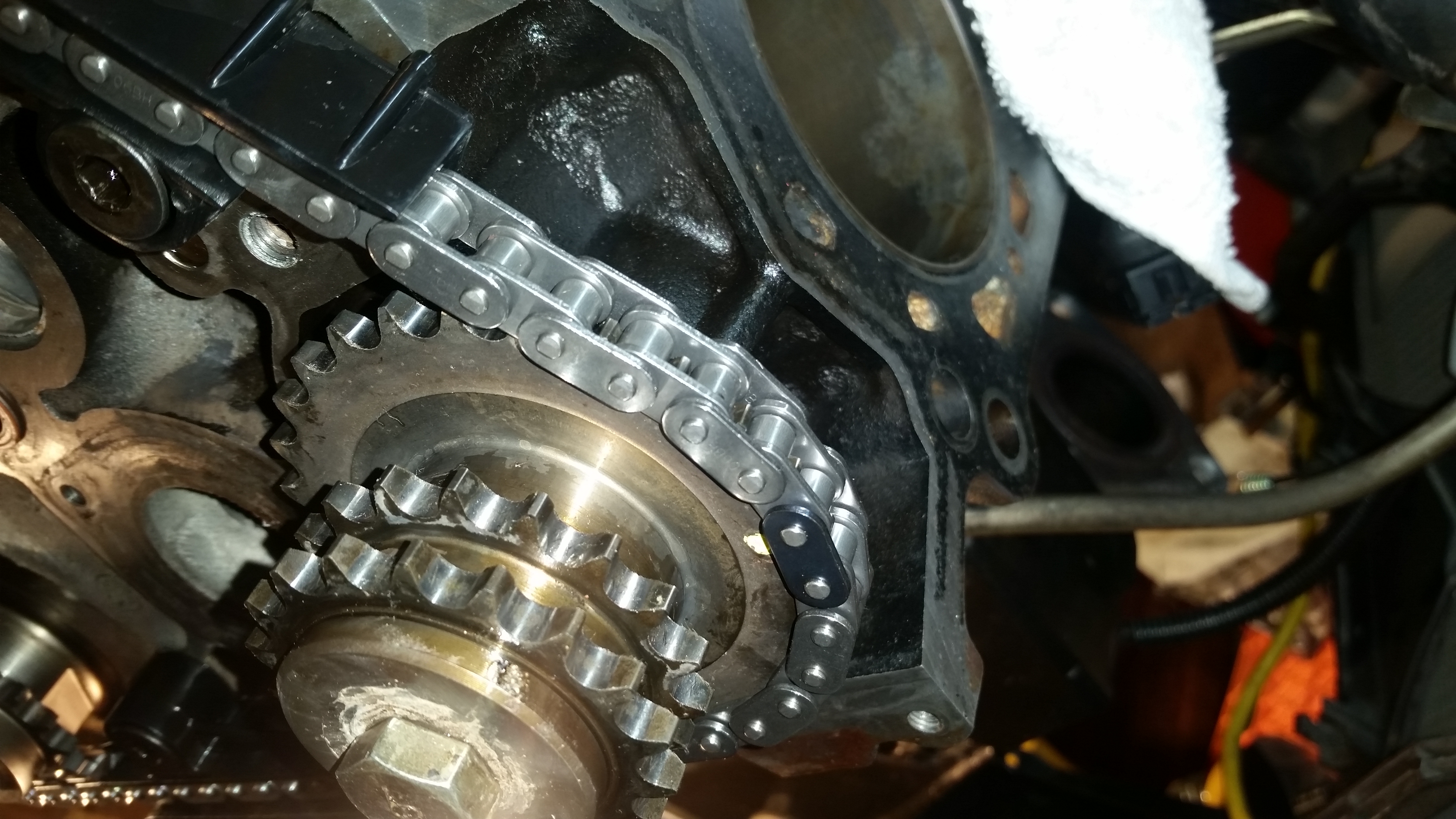

James, thanks for responding, I knew you'd have some input.Here is a picture of the car, and the angle of the hill, if you can tell. I'm going to get 5 gallons of fresh gas now.
Yes, after installing chains, I spun the engine, by hand, many times and checked them repeatedly. Maybe I made a mistake? I doubt it though, because I was so worried about it, I checked everything at least ten times, and for 10-20 revolutions. Attached are a few pics of the lower chains, can't seem to find pictures of the top chains right now.
My coil packs are brand new, OEM, as of 14 months ago. However I have lots of working spares, so I can quickly swap them. I also have a running automatic VE, I'll grab that today so I can swap parts from a known running car.
It does sound like the timing is way off, I just don't see how. I'll also check over my vacuum.
