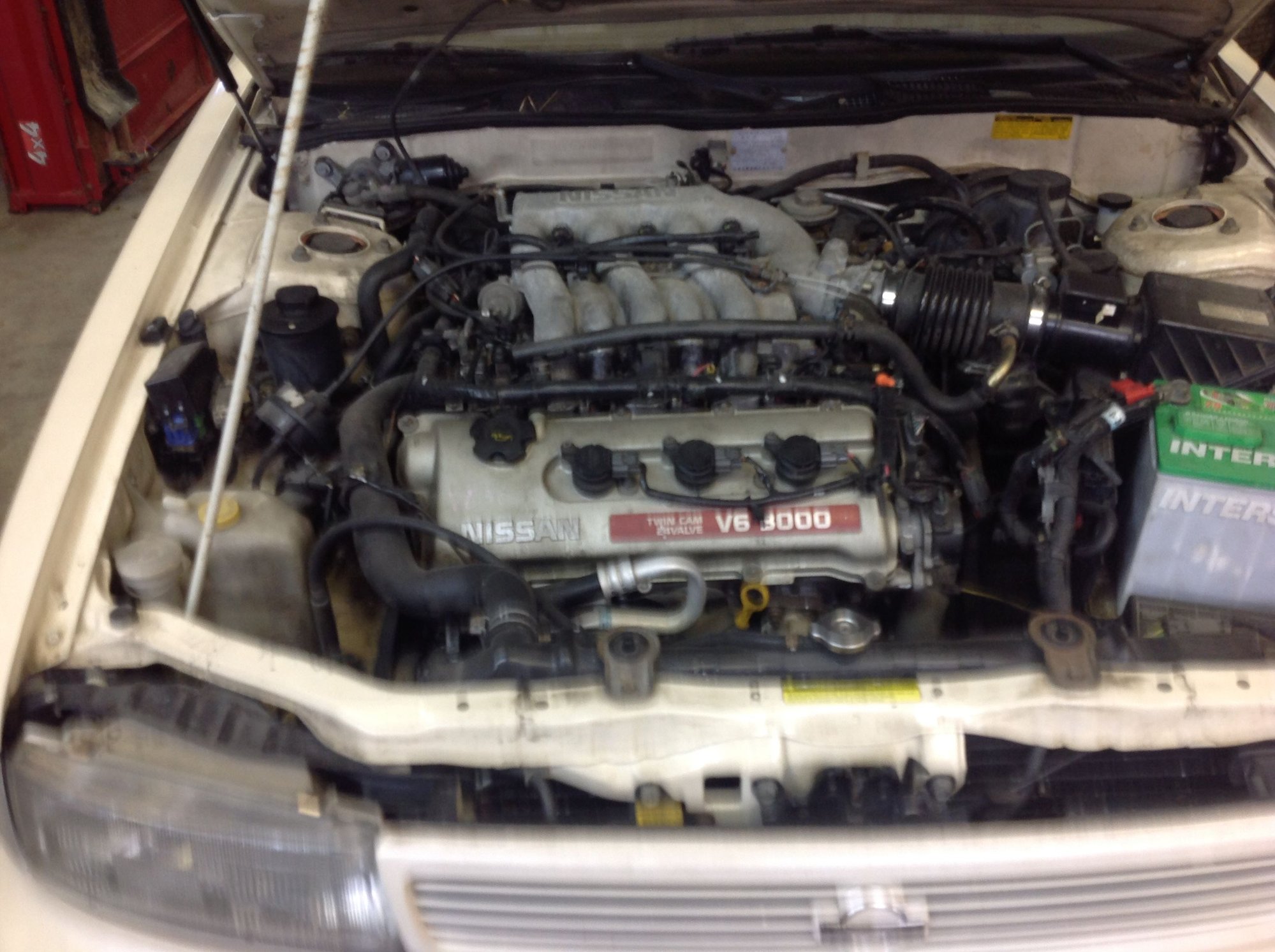

Been dealing with this problem for the last 10-12 years after replacing my 1994/5 Max SE VG30DE SOHC V6 with same bought directly from Japan.
Was able to find one with only 13,000 miles.My old engine had over 200,000 miles and the timing chain had been sounding like a diesel running for around 100,000 miles before replacing the tensioners with no change it the sound.
Every thing plugged right up and engine started and seemed to be alright until driving it up to cruising speed and when driving at steady speed it began to fail like turning off the key all the way down to just barely running.If I give it gas it comes right back and runs fine,but if I hold steady throttle is just almost quits.Runs great if driving like race car,giving gas and letting off.
I've spent thousands of $ with Nissan repair ,local mechanics ,and had it in the local high-school vocational mechanics class for the last 5 years thinking they would have the latest diagnostic equipment and could fix it.WONG.
There are at least 6-7 different mechanics that said they hadn't ever seen one they couldn't fix eating crow now.
Nissan said they couldn't do anymore till I bought new PCM but after trying 3-4 different ones with same problem they said they couldn't repair it and not to bring it back.All the local guys want to do is replace parts and sensors till they find the problem but never could,and each one you take it to wants to start over with there (new parts).
I have the car back in my garage now but still the same problem 10 years and several thousand dollars later.
SO I keep reading Nissan forums and watching the 10 year old (NEW) tires dry-rot on my car.

pictures
Got some photoes,still learning to use the ipad.
Old Mar 5, 2017 | 03:02 AM
angus1x's Avatar
Joined: Dec 2016
Posts: 39
Wow,sure are large pictures

Old Mar 5, 2017 | 08:46 AM
Tiniform's Avatar
Joined: Nov 2012
Posts: 249
From: Fl, USA
Good looking max. Hope you will get it running correctly.
