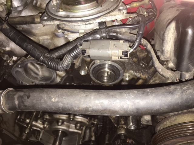

Also bought new seals for the cams and crank. I'm down to those seals right now. Here's hoping they come out and go in smoothly...

Be sure that you have the plate between the crank sprocket and seal, as well as the concave/vex one between the crank sprocket and pulley, and that both are installed in the correct orientation. Check that you don't have the longer water pump bolt installed in the wrong position that is close to the belt. Your belt got damaged somehow.
Good you're doing the seals. How did you go about locking your cams? Thankfully O'Reilly has a loaner, felt like a sketchy tool at first, it's made of some composite plastic and grabs the pulley with two opposing teeth. Holds pretty well though when you get it set securely.
I had a friend helping me so what we did was I put a wrench on the right camshaft pulley bolt and held it in place while he put another wrench on the left one and loosened it up. Once the left one was loose I used an impact wrench on the right one because I had room to do it. Worked great! We had them off in no time.

I was surprised to discover how much of a mess a leaking camshaft seal can make . I pulled oil cakes out of my timing cover.

Sounds like a good plan. It disturbed me to discover how much oil collected behind the timing cover (and consequently on the timing belt itself).

Either way I would definitely recommend taking it off the road for further inspection. What you don't want is coolant getting on the timing belt over and over again because it will degrade the belt and shorten its lifespan. When was the last time your timing belt was changed?

Originally Posted by AzureblueZ
The waterpump has a weep hole where coolant gets forced out when the pump begins to wear out. There is only one small coolant hose in that area. It runs from the top of the motor where you can see pretty easily down a short distance to the thermostat and back into the motor. My money is on the waterpump.
i pulled off my fender liner and undertray to get a better view from underneath and had my friend pour water into the radiator and it is the water pump its coming from the bottom of the pump behind the pully and i dont know when the timing belt was last done i just got the car back in september

Originally Posted by That_93maxima
and while looking at it i noticed my timing belt looks the same as yours does maybe even worse
Also, you may be looking at your accessory belts. The timing belt is not readily visible because it is located behind the timing covers. Unless, by some weird chance, your timing covers were not reinstalled and your timing belt is completely exposed
it looks like my lower timing cover isnt there its very dirty down there because of an oil leak it had when i got it (oil pan gasket and its been fixed) im going to clean it up some im hoping its just an accessory belt

Youch!
I can relate. When I took my timing covers off there was oil caked so thick on the backside of the timing covers from one of the cam seals leaking. If you fix the leaks it's pretty easy to clean up the timing covers.
That's scary that your lower timing cover is missing
Do you have it lying around (did you leave it off)? If anything gets between the timing gear teeth and that belt you'll be smoked my friend.
There are 3 accessory belts on the front of the motor. The timing belt is behind them, and behind the top cover that it sounds like you still have. If you see damage on the exposed timing belt I would highly recommend taking it off of the road until you can address the problem. If that timing belt breaks you're out a motor. If it even skips a few teeth the car won't run well or at all.
