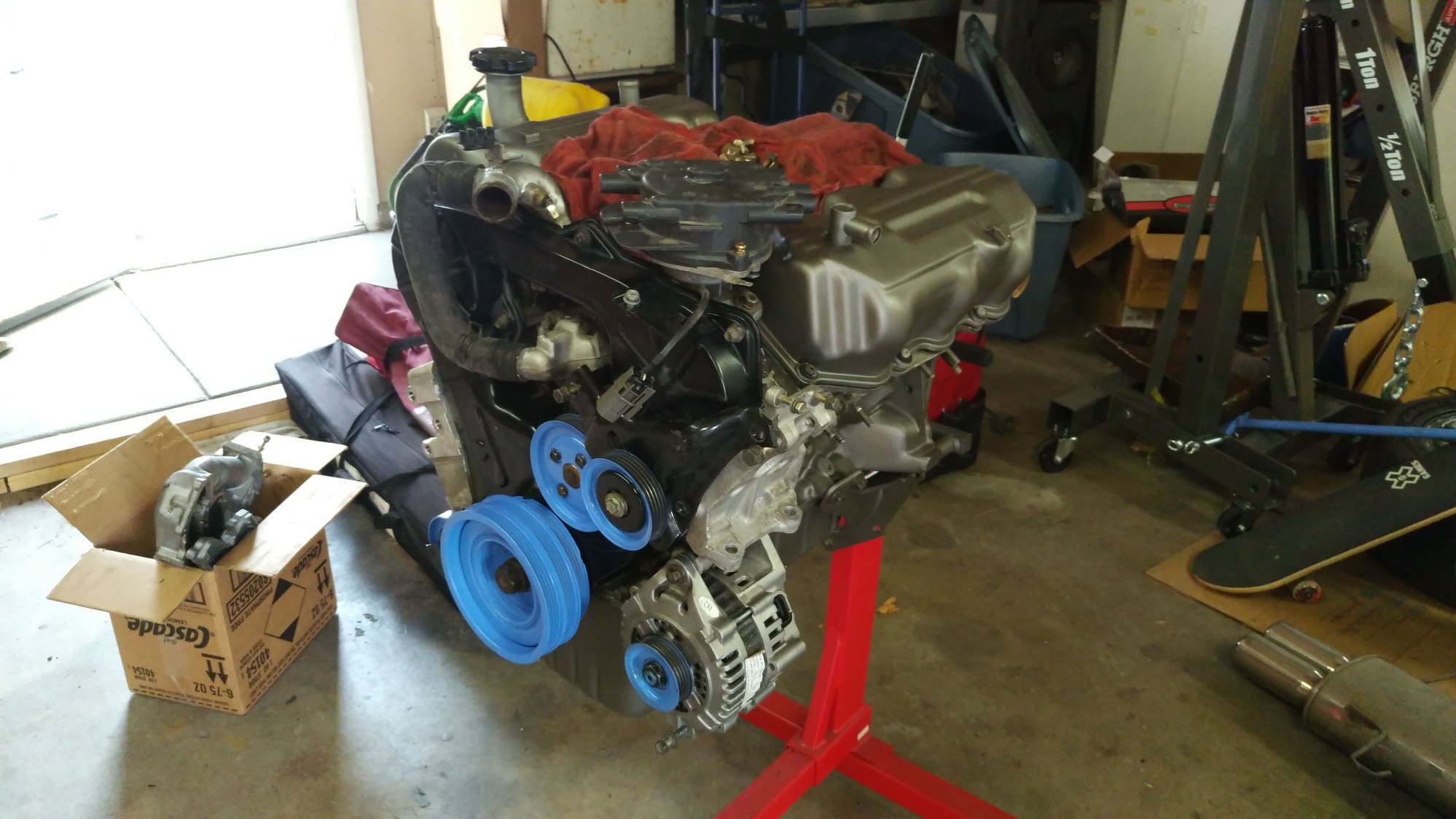

getting close

The tidiness of your garage is obscene. Did you just move in?
Thanks for sharing all these pix, they brought memories of my long gone VG and a smile.

No all the parts were packed away and I had to pull everything out. As stuff is being installed the garage is getting cleaned up. Plus the garage really isn't big enough to hold all my tools.

I like the blue!

Blue pulleys? You might wanna ceramic coat those headers....and weld the area between where the two secondaries merge!!! They will leak there!
