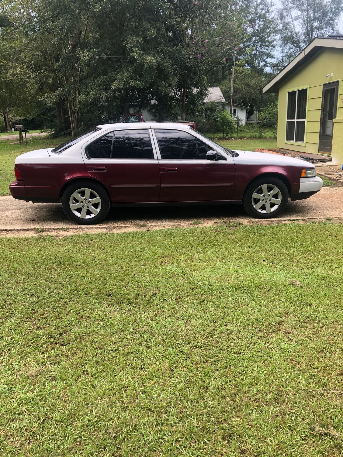

Dash lights went out but when pressing brake pedal dash lights come back on!? Any idea what’s causing this and how can I fix it! Thanks in advance

Issue fixed
It was just a fuse!!!! Think I shorted out fuse when changing headlights a couple days before this! Fuse was hot on one side and still in contact but after I replaced fuse, dash lights came back on and brake light works properly
