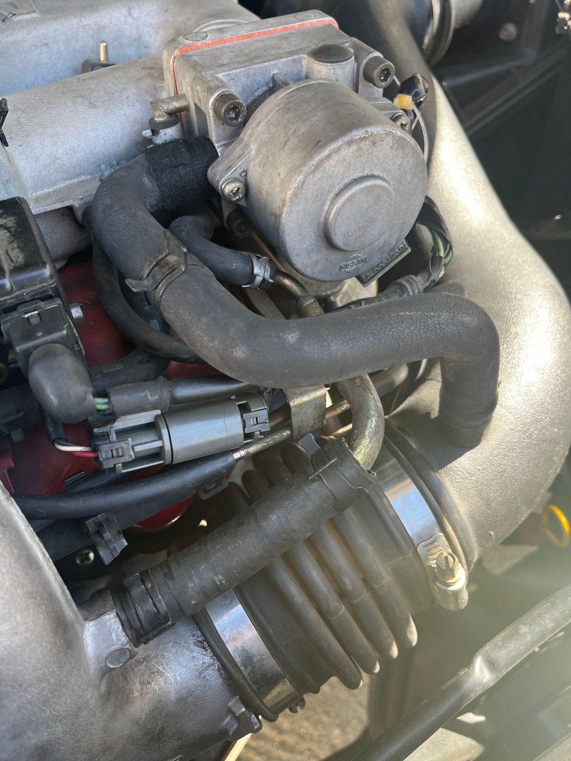

my idle air control valve was messed up cleaned put back still was ****, got one from a 94 in a junkyard about 30 minutes from where i live and i needed to replace some of the thicker hoses connecting to the intake that part that exposes the throttle body blah blah but this hose that connects from the iacv to the air intake has a specific mold/bend to it to make it fit and i can't find it for the life of me, im not too familiar with the process of getting them in that condition either can anyone help me out with the picture i provided

Take the Hose off and take it to the parts store, go look for your self in the back and find a 5/8 hose that has a similar shape to cut it from. Finding one that is not split or dry will be tough these days. I have used a piece of regular 5/8 and just curved it down also. It isn't oem looking, but it doesn't leak. Until you can track down something closer to oe.

ending up just making something work yeah appreciate it sorry for the late reply
