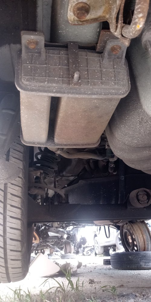

Old Sep 27, 2019 | 06:27 AM
Roy Holley's Avatar
Joined: Jun 2019
Posts: 13
From: Tampa Florida

EVAPcannister behind drivers side rear tire

Roy - That is the canister. The valve is attached to the other side of your photo.

I had a few months of Evap codes after I bought the 98 model. It turned out the canister was bad and let charcoal clog the line. So I had to disconnect the line at the control valve in the engine compartment, then again at the canister and apply 125 lbs of compressed air to clear the clogged line. When the clog finally cleared, it dumped a cup of charcoal on the driveway.
The canister for the 98 model was a low cost part. The 99 models are considerably more expensive. I would replace an old canister as preventative maintenance because they can leak charcoal and cause all kinds of Evap headaches.
Here's a Maxima with charcoal all in the line from a bad Evap canister.
