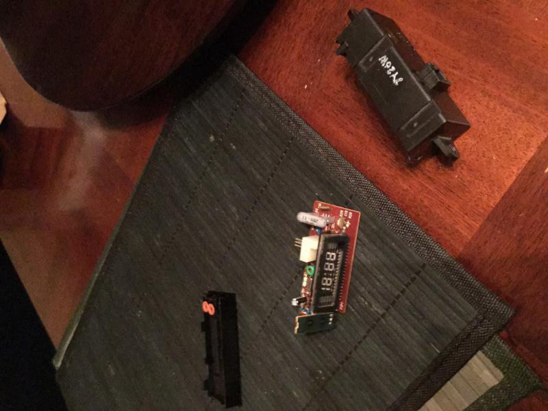

Old Jan 28, 2015 | 07:24 PM
poplifedc's Avatar
Joined: Apr 2005
From: DC metro area
Clocked fixed
I gre impatient while waiting for a replacement clock. So I pulled it out and took a look. I cleaned the silver prongs and plugged it back in. Clock came on and went off. So it was a connection issue. Took a small screwdriver and pressed the silver prongs on the white/tan female end. Added some Dielectric grease and it works.
Soooo I'll have a spare clock when it comes in.

Old Jan 28, 2015 | 07:26 PM
poplifedc's Avatar
Joined: Apr 2005
From: DC metro area
Done
It works.
