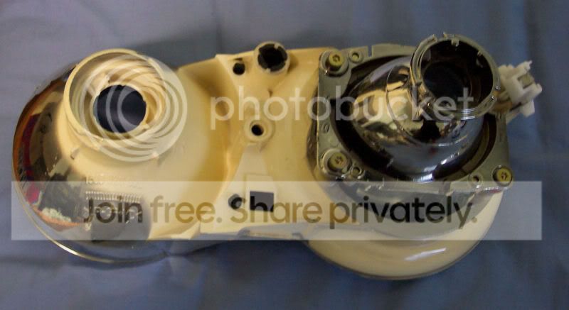

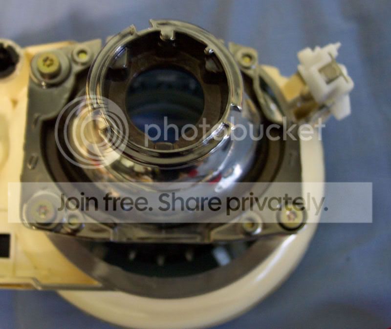

The bezel seems to be part of the rest of headlight chrome/housing...how did you guys seperate this? I thought it was supposed to be seperate?

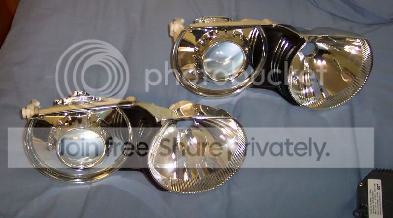

Also I noticed that I ended up with 2 right side projectors/bezels...any problem with this, or should I demand that I get a left and right side from the seller?
Additionally what type of drive did you use to remove the projector from the bezel/housing?
Also for you E46 single xenon retrofit guys, did you use the OEM bezel or a differnet bezel?
Thanks

The projectors should come off the bezel if you remove the 4 screws. I'm not sure what type of driver that is but they should sell it at Sears.
This is what I used for my bezel:

use a torx bit to take the projectors out. the bezel is clipped onto the projector by two clips. if you try to pop the bezel out w/o taking the projectors off first, you might snap a clip, they're fragile.

Oh yeah it should be fine that you have 2 of the same sides. The projectors should be the same.

those projectors have tamper proof torx on them, dont forget that and get the regular torx cuz they wont fit.
