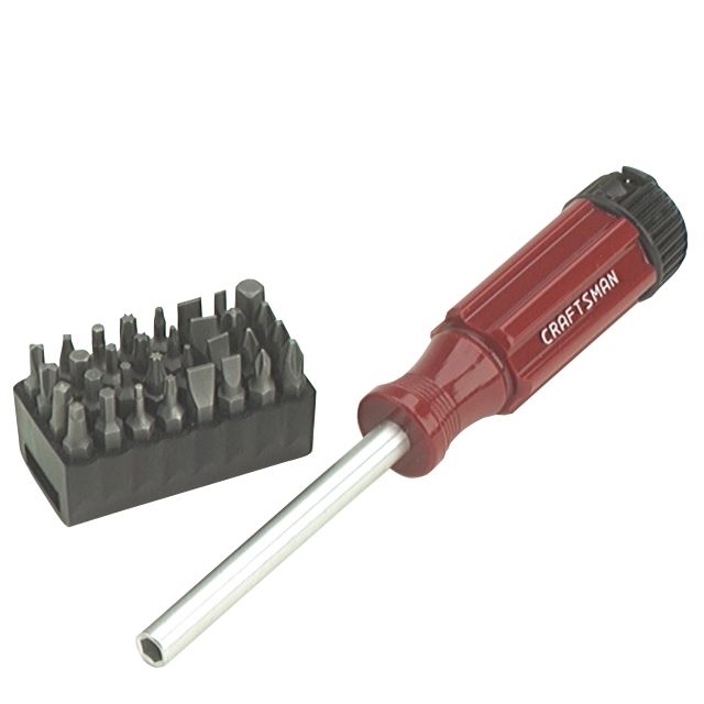

took me like 10 min. there are 4 screws that hold the ecu into it's bracket thing.
i use a philips head from a kit like this, and just pressed the head against the screw while using a small open end wrench to turn it.
Old Nov 11, 2005 | 05:17 PM
joosdawg's Avatar
Posts: 1,745
From: Appleton, WI
wow thats an awsome idea i think i would deff do that if i had to do it again, cant belive i didnt think of that. Good thinking aznsap!
