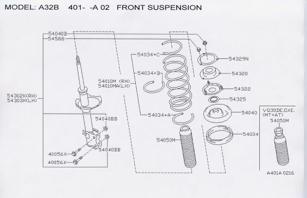

how many washers are there supposed to be???? i only see one black plastic washer with a blue ring inside of it....also which way do you put it on because both ways fit ??

Old Feb 28, 2006 | 09:56 PM
Poowill's Avatar
iTrader: (12)
Posts: 1,259
See if this helps.
