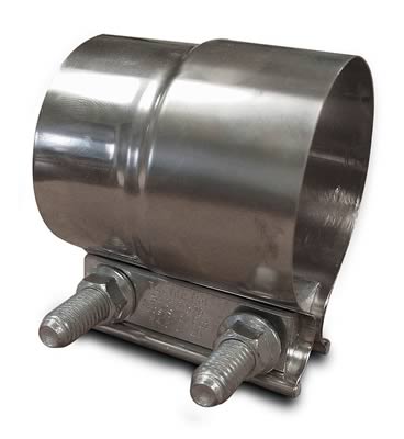

mine used to leak right there too and i had to sandwich 2 gaskets together so it would stop leaking.
What i'm talking about doing is simply what they do on alot of american car exhaust set-ups. It basically makes it so there arent flanges or gaskets.
something similar to this
My biggest problem is with where the y pipe connects to the cat and the cat connects to the B pipe, i dont feel like thats making a good seal and if im gonna replace it I might as well just get a universal set up and connect it easier with the clamps. The thing is, like you said, the y pipe has a bigger outlet than the greddy b pipe inlet.
