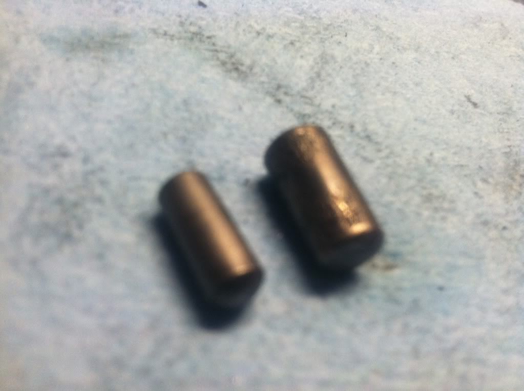

Excellent write up and I'm in process of putting it all back together. I was careful not to lose any check *****, but just realized I'm missing an interlock plunger- I'm assuming the small plunger. I found the piece below (left) under my bench and am wondering if this is it. I set it next to one of my old diff bearing rollers (right) to give some perspective. This seems very small if it is indeed the small plunger, but am hoping it is. Can anyone tell me?
Old Feb 12, 2012 | 02:30 AM
  #103
dgeesaman's Avatar
Maintenance Monster
Joined: Jul 2001
Posts: 3,231
From: Harrisburg, PA
Hard to tell in the pic, but if it's a straight cylinder with equally rounded ends, then yes that's it. It's the only transmission part that will fit in the shift rod.
You can buy another from Nissan if need be.

That's it! I'm a little slow with the obvious at times; I just realized the small plunger actually inserts into the middle shift rod. Possibly, if the FSM didn't completely suck I'd be done by now. :/
Old Feb 12, 2012 | 06:04 PM
  #105
JtzMax's Avatar
Whatchyou say?
Joined: Apr 2007
Posts: 1,869
From: Springfield, Missouri
Yep, you need that plunger in there .... Sucks to find it after you put it all back together, but hey ... at least you found it!
