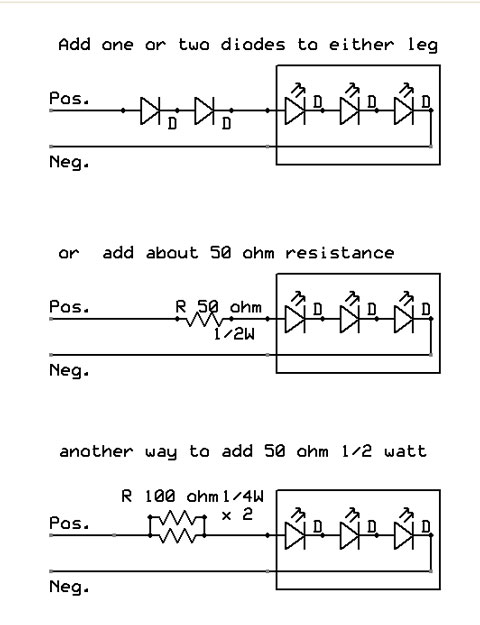

50ohm resistors(or 100ohm) - See http://www.rcaz.com/images/electroni...r_solution.jpg

Remove the map light by just pulling it down. It will come out easily. Get the boards and glue one board in the middle. Take another board and remove it from its base. Glue this one in next to the first board.
Solder one ground to another.
- Yes I know it looks like **** but I don't want any comments on it
Run the wires through the holes and solder in as shown. The grey wire with the blue stripe is POSITIVE and the solid wire is the NEG.

This is how I installed the boards. Connect the grounds to eachother and you want to make sure you connect the grounds to the WHITE wire and the white wire ONLY. If you don't you would be able to retain the ON and Door open function. The hot glue also keeps the connections from touching so they wont short out.
Run the wires as shown.
Install like shown. The Grey/blue wire is positive once again.

ya, i bought LEDs for cheap and PC Board and did this project a few years back.
kevlo you did a great job. i'll add my pics so people have more reference as well.
how i did the courtest lights (in the door). you can google up 'led calculator' to figure out what ohm resistors you need depending on how many led's are in your array.
test fitting of the pc board i cut out in the map light. i had to do some dremeling and use one of the stock screws to hold the pcb in place.
back of the pcb. keep the soldering clean and make sure the contacts are firm. i recommend using flux and running the + and - in opposite directions.
how i put everything together. make sure you have a resistor in there
the what it looks like in, all ready to go

I just did the modification today to all the bulb interior lights (dome, map, and both doors) using a Ratshack perf board like you did. They fit like a champ.
I wired everything series-parallel in groups of three, using a 100 ohm resistor to manage current on each of the series legs. Although not necessary, I also used an LM317T variable voltage regulator (wired with a single sensing resistor so it performs as a current regulator) for the map light and dome light so regardless of the battery voltage they will remain the same brightness. Works pretty well.
Thanks for the photos that got me started on this project!
As an aside, just looking at some of the way people have their LED's wired in an array, I would only expect to see a few hundred hours of lifespan from running them way, WAY over the rated current. Brush up on Ohm's law before you do this, unless you want to have to pull your boards out again. Running 20mA or less should get you a long, long LED life.... much longer than the life of the car.

That write up is for 3v? Did you get it up to 12v? I would assume the wireing is backwards if it works with a 9v batt and not the car. Did you try it on the car batt?
Old Feb 5, 2009 | 06:07 AM
Dome1's Avatar
Joined: Dec 2008
Posts: 29
What do you mean did I get it up to a 12v. Well from that write up instead of using a 47ohm resistor I am using a 100ohm.
Old Feb 5, 2009 | 07:04 AM
Kevlo911's Avatar
Kevlo for President
iTrader: (36)
Posts: 35,755
From: Lake Orion, MI
My bad i misread what you are trying to do. If you are using one led, it is not gonna be very bright but. To get the right resistor you need the specs on the led and plugging it into:
http://led.linear1.org/1led.wiz
To get the proper resistor.
Oh man I want to do this so bad. These are the boards I found (UV)
EBAY
But I'm still a little confused, even with the calculator.
If I use two of these for the center dome, it will be 16 Leds...so I put the source voltage as 13.4 (car batt)..3.3 forward voltage and 20mA and it says I need 1/4W resistors....12ohm for four leds...
The way the wiring diagram shows it is wiring four leds, to four resistors, but in this case it would be 8 leds to one resistor because of the board...
ARRGHHH am I on the right track here?
