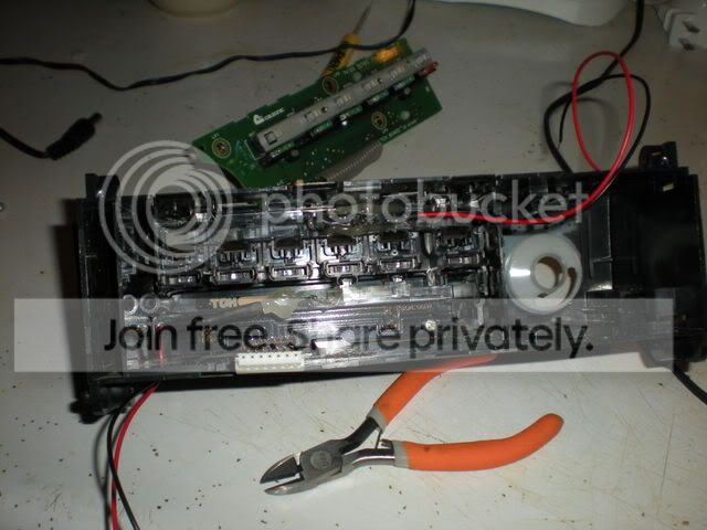

hey everybody just finished my ac controls and wanted people to see this to give yall a new idea well i really dont know if its a new idea but i havent seen people do this but i might be wrong well at least a new idea for the control ****!!!!!Let me know what yall think!!!!

thats pretty cool... was it hard to do?

How did you do the red clock? That looks really cool.

not really you just stick an led in the **** and dremel a hole to stick the wire through the control unit
i just used red cellophane i was trying to do the white clock mod and it came out like this and it matched my hazard and defroster buttons so i left it like that

oc wicked.... What exact combo did you use for your led's? .... pnp or soldered?... brand?
Your white is crisp and clean....
how many layers of the red did you use. And is it true red or magenta?

i just use prewired 5mm leds from ebay i think those are the best if your really not into sodering you just place them where you want and run the wires to a 12v source!! and as for how many layers and what color it was. it is just one layer and the color im not sure i just had i layin around my house but it is very dark red color i tell u that during the day u really cant see it but i really wasnt worried as my cd player displays the time also

Looks good! Can you use those same prewired 5mm for the rest of the buttons that need lights?

by buttons do you mean the window switches? or hazard and rear defroster? for the window switches i used 3mm and as for the hazard button and rear defroster i bought 2 red leds from radioshack and some 470ohm resistors but if you want to buy the prewired ones you can just take the heatshrink from them and they have a resistor sodered to them already and you can just cut the wires off

I mean the climate control buttons. The ones you use to select wether you want the air for your face, feet ect......or were those included in the mod?

oh ok! there is a a clear bar that is used to distribute the light you can see it in the pic but i ended up putin three more leds on the plastic clear bar but yes you can use the same wired leds

everything looks good but how come u left the indicators as green still??

i still wanted it to look kinda stock without going overboard on the leds plus where the green indicators go is clear lens if i was to put an led there it would just be too bright and shine through very bright and i would have to use resistors to dim the light down and it is a tight fit in there not much room plus i wanted a simple but good lookin install on my leds dont want a very bright light shining in my face while driving

with all the wires from the LEDs, where did you connect them?

i used the FSM to find the power wires for lighting for both the gauges and climate control and just tapped into those.
