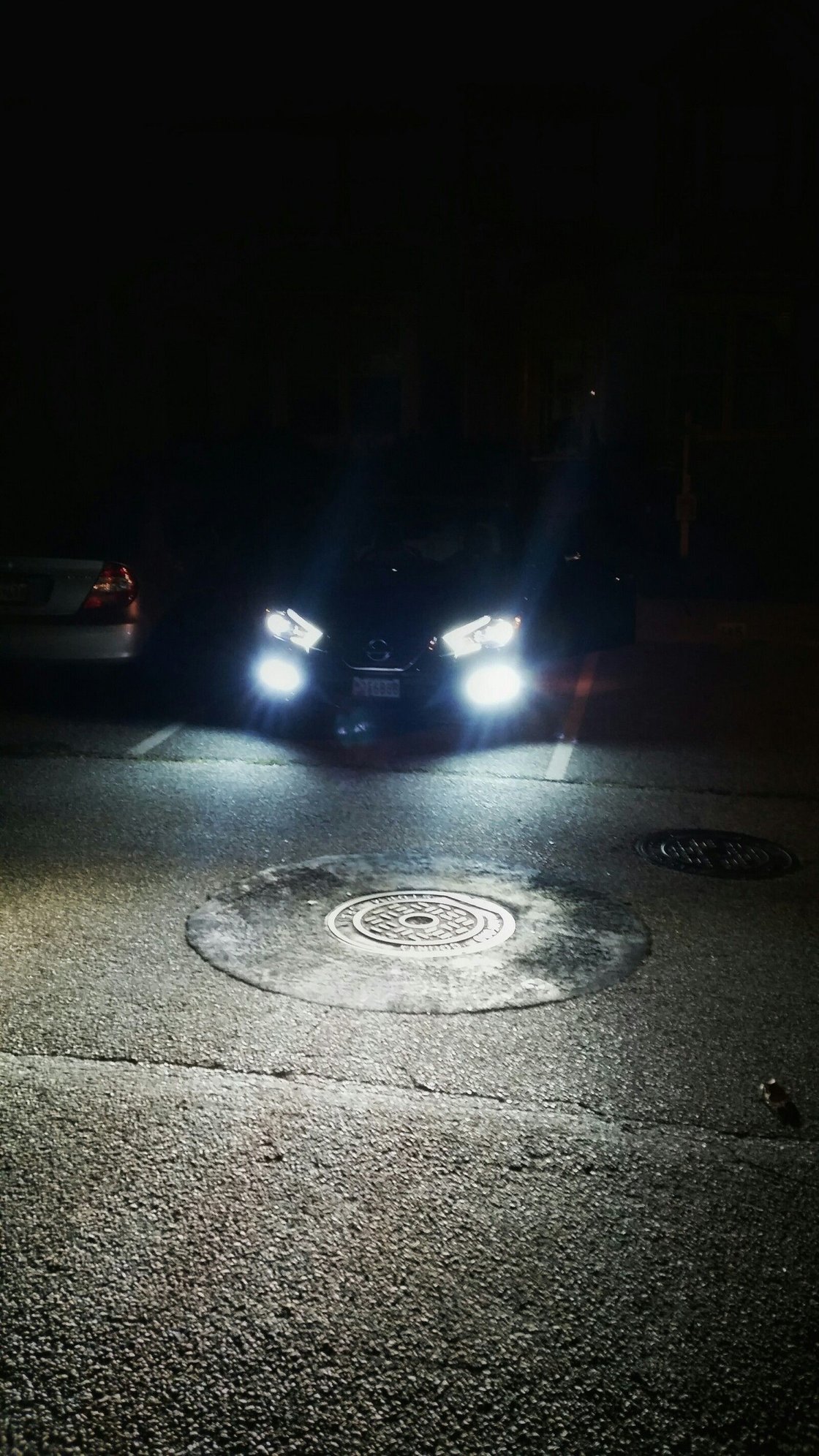

Old Sep 28, 2015 | 05:53 AM
mpbclutch33's Avatar
Joined: Aug 2015
Posts: 101
Finally got my HIDs and LED Fogs installed. Pics dont do them justice. They look great and they match pretty well. Pretty happy. Hope both of them last.....

Mpbclutch33, looks awesome. How long did the fog bulb replacement take? What do I need to get besides the bulbs. Any instructions on how to do it?

They are plug-n-play. I had my bumper off to do the HID'S so it was a lot easier. I also put some silicone around the fog light housings and bulbs cause I have already had moisture issues. So far so good.
