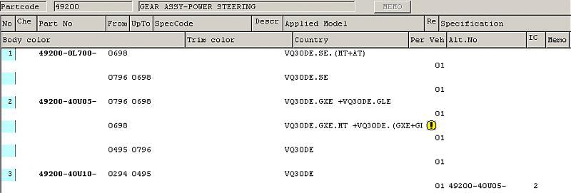

I looked it up in Nissan FAST, and I don't see any evidence of the 99s being different. The SEs are different from 97+, but nothing changed from 97 to 99.
Here are the selections for steering rack assemblies in FAST:
And note too the description of the various parts from a major online parts dealer:
492000L700 $888.85 $0.00 $693.30
Steering gear and linkage - Steering gear and linkage - Gear - Se
Se 1997 - 1999
Versus:
4920040U05 $888.85 $0.00 $693.30
Gear 1995 - 1996
Steering gear and linkage - Steering gear and linkage - Gear - Gxe and gle
Gxe and gle 1997 - 1999
So I don't see any evidence to suggest other than the SE and GLE/GXE are different from 97 up and the 99s are not special. FWIW, my car is a 97 SE and the rack has failed twice (the second time due to me not cleaning the hoses properly during installation - DOH!)

hmmm thanks for the information. So there is no way to tell what standard the aftermarket assemblies meet since they are all for 95-99 anyway...I was just hoping to get a sportier feel but I"m certainly not going to pay 900 bucks for one.
how did you improperly clean the hoses??
