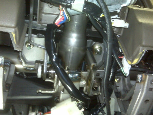

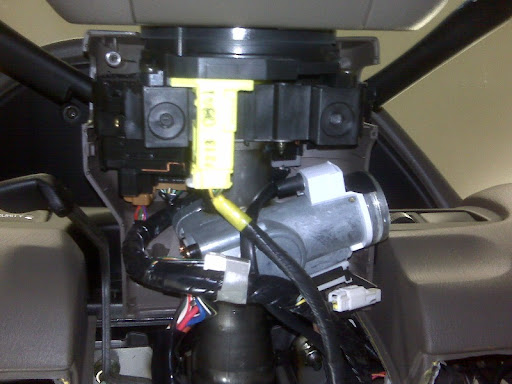

alright so this is where you'll need to lay on your back the best you can. you're going to be reaching up between the side of the car and where the clutch pedal is.
this is what they look like, the black topped cylindrical things with gray tips where they connect , there are two, the one closest to the floor is for the power seats so they shouldn't affect the dash. if it is the breaker, it would be the other one above it.
this is another view, it's what you'll see when you poke your head under the dash, give or take a few wires...

wow thanks for the pics. i think it makes sense too that its a breaker especially by the clicking noise but the one thing i dont understand is how can a breaker click and break then reset itself? it went dead then came back then went dead again...
Ill go pull those now and check them out, this would be great and easy is it was one of them but how would i know? what would i be looking for on the breaker? The seat still works.. maybe ill try and swap then and see if the dash works and the seat stops.
