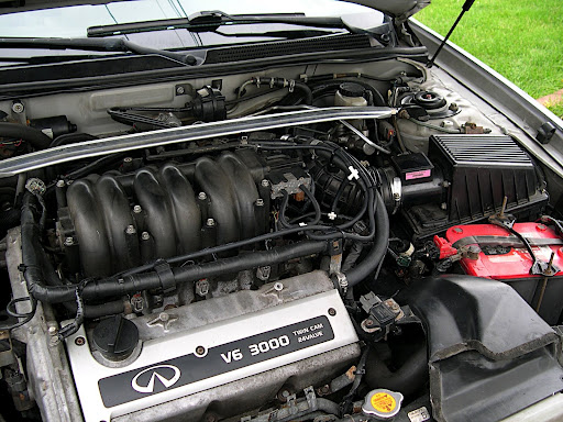

I rock the half & half on my A33B. Stock airbox, straight MP. The sound alone is worth it. It's very smooth too.

I have to ask now that I've seen it: is the air box bolted in? (i.e. the 3 bolts at the bottom)

Have you tried using the stock midpipe along with the lower intake pipe going through the fender? I am currently using that setup and it seems to be the best. I've tried several different ways, and this seems to work great.

I'm primarily going for thermal effeciency here in addition to a bit of sound. Being able to use cheap panel filters is also a plus. I may make a new scoop though, because the factory one has some less-than-optimal design points.

Went to install mine tonight and realized two things:
1. My eBay midpipe is indeed curved at one end.
2. I don't have enough couplers. I only had one included with it from the previous owner that was usable, and it's an ugly blue color anyway.
Going to Lowe's tomorrow to buy some nice black couplers and painting the midpipe flat black.

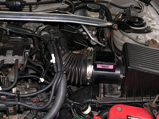

Intake parts finally got in yesterday and all I can say is FAILURE. I am really saddened by just how low in quality these intakes are getting. I had to modify one of the couplers to even get it on the MAF and the ports on the tube aren't the right sizes (the one for the valve cover hose was the same size as the IACV! ). On top of that, the ports are placed in positions such that I can't get the couplers on far enough to make anything fit. I tried the other intake tube I had laying around and it was too awkward to work, too.
Long story short, neither intake tube is a suitable length. They keep the top half of the air box from bolting to the bottom half by about 0.5". I considered cutting some length out of one of the tubes, but it would either compromise the bend (which is needed) or take away even more length near the ports, which wouldn't allow the couplers to fit properly anyway.
I'm abandoning this project because I'm selling the car so it's not worth spending a bunch of money trying to get the right size tube with the ports positioned right. Glad I spent the money

Originally Posted by HomerMAC
Im a bit of an OEM junkie.. so i used nissan parts...
2000-2004 q45 (plastic) intake tube between tb and maf.
it has two ports for big hoses.. 1 is connected to the engine breather. other big one is closed off.. and a small air vac tube for the little things.
fits perfectly snug between pathfinder tb and maf as well cause the tb end is big in diameter.
I might even use this for Supercharger cause the accordian piece bends straight forward... hmm...
wow, that looks really good. i might have to steal your idea if i decide to keep the 00vi. how much did you pick up that pipe for and where if you don't mind me asking?
