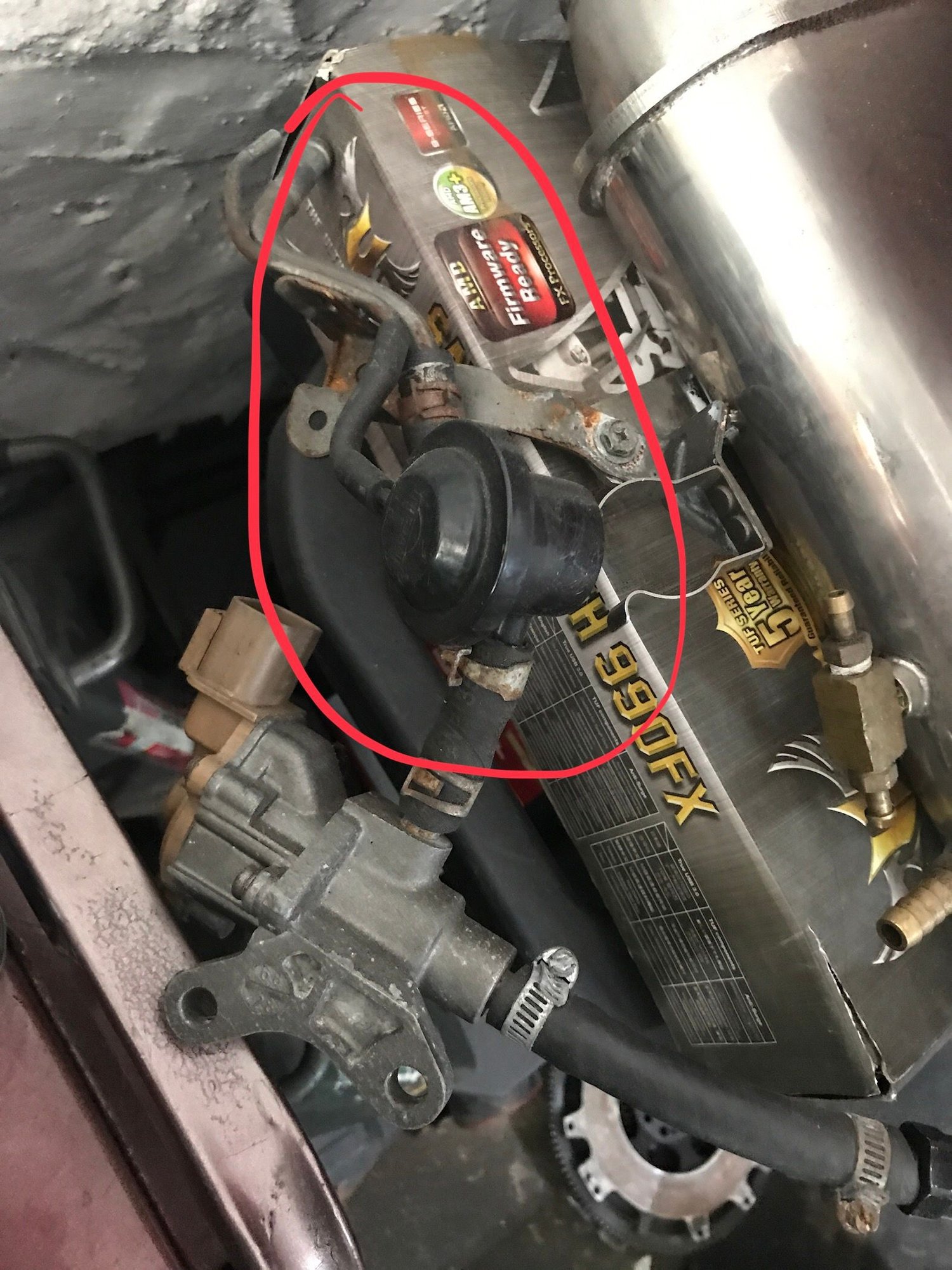

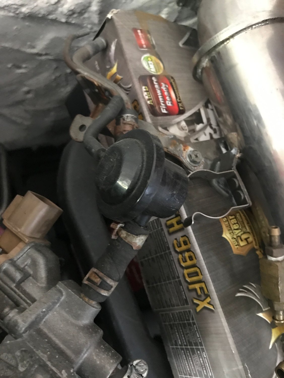

Bringing this back im wondering if anyone can help with this. I did the 3.5 swap and had EGR deleted in Nistune, the guy working on my car is saying I still need the evap canister purge valve and purge control solenoid connected with vacuum and plugged in to the harness.
I just have the Egr sensor dangling, and the green EGR solenoid connected. My question is whether I deleted this EGR in Nistune or not ( 95 ECU ) would I get any codes for EGR if I left this disconnected? I included a photo. Its the evap purge control valve and evap purge solenoid.
