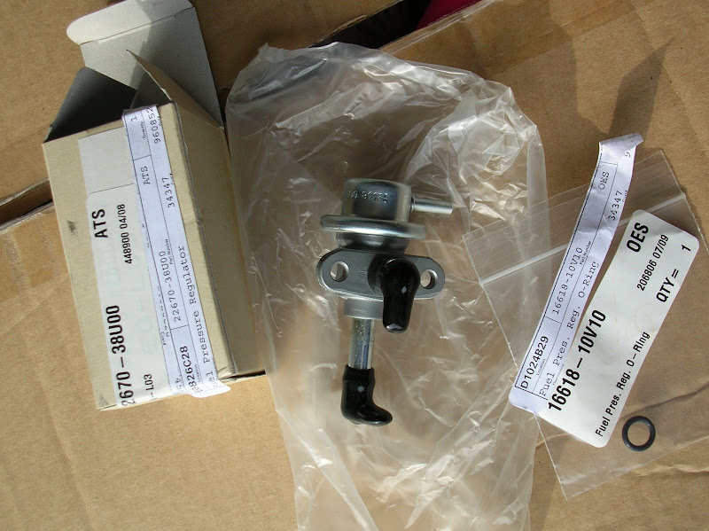

Good result after swapping out the FPR.
It has only been two days since I replaced the new FPR - it might still be too early to declare victory. Nevertheless, I got a strong feeling that the FPR leaking pressure was my problem.
Many thanks lbrowne for the instruction, I have ordered a new FPR (together with a new o-ring) and installed it over the weekend. The starting hesitation never happened, even at 40+F degree this morning... From the way that the car fires up, I have a feeling that the problem has been fixed. What I am not convinced however is whether the new FPR did the trick or just a new O-ring. I replaced both as I have them in hand. But if it came around again, I would probably try to replace the $2 O-ring first before commit to an expensive FPR...
Old Oct 13, 2009 | 07:38 PM
wxm's Avatar
wxm
Joined: Aug 2008
Posts: 356
From: New Jersey

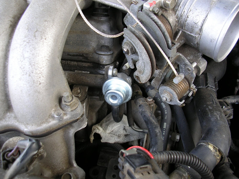

How to replace the FPR...
[Warning] The gasoline is extremely flammable and you can never be too careful while working on a fuel line. I actually waited for the engine to cool down completely before starting to replace the FPR.
Again, many thanks for lbrowne for the steps of replacing the FPR, I figure to put them down here with pictures so that others can share them too.
(1) First of to release the fuel pressure. I did this by starting the car, removed the fuel pump fuse and let the car die. You'd be happy you did this when it comes to remove the FPR later on.
(2) Remove the resonator, top of airbox. Be sure to mark the hoses and connectors that you disconnect so that you know how to put them back later on.
(3) Many have also removed the Throttle body to gain enough room to access the FPR. This is also a good time to clean up the back side of the TB. I did not remove the TB as I just did the TB and IAVC clean up months ago, and I also get a good screw driver and hose removal tool which allow me to access the screws (underneath the TB) and remove the fuel hose in tight space.
(4) Remove the top/bottom screws on the FPR. Be extremely careful with the two screws. The really wanted to strip easily. Many had this problem which turned a small job a cursing exercise. Be sure to get yourself a proper sized phillips. I also hit the screws with the PB a day earlier.
(5) Put down some paper towel or cloth underneath the FPR to catch the residual gas that may leak out once the FPR pulled out.
(6) Once the screws removed, you can then pull the FPR out. Depending on how much pressure left in the system, you may need to pry it out gently. Mine came out easily with one pry of the flat head screw driver.
(7) Pull off the air tube underneath, and lose the fuse hose clamp, and take out the fuel hose. This may take some patience. If you have a pair of hose removal pliers like I do, you'd be happy for the investment - it made the hose removal a snap. (You can get the tool from Harbor Freight for about $10).
(8) Install a new o-ring on FPR (I always put down some grease when I install an O-ring). Slide the FPR in, and reconnect air tube and fuel hose, tighten the fuel hose clamp.
(9) Remove towel and cloth that you put down in step (5)
(10) Tighten the screws on FPR and reinstall the air box and connectors that you removed from step 2.
(11) Reconnect the air hose, and tighten its clamp.
(12) Reinstall the fuel pump fuse.
Before you starting the car again, double check the fuel line to make sure there is no fuel leak and no spilled over gas in the surrounding area.

With regards to those screws, even with the proper sized Phillips they can still strip - as they did in my case. Which then lead to cursing and then later a sigh of relief after using an air tool. (won't get into those details lol)
I think if the o-ring was faulty you would have had a smell of gas under the hood and/or could see gas leaking out around the FPR. I had neither, so I'm pretty sure in my case the FPR itself was just faulty.
But if you're changing, for sure spend the buck or two on a new o-ring!
Those stickers on the FPR box look familiar
When I did this fix, I also removed the intake resonator altogether. The hose fitting on the bottom that the resonator attaches to can be plugged/capped perfectly with the top of a K&N air filter charger cap. (off the top of the small aerosol can)
