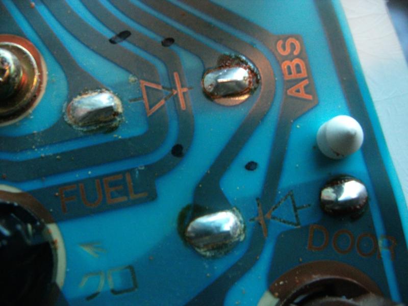

O.K I know this is an old thread but I can't make my own and google leads you here from your own search engine. So here it goes:
I had the same problem and after the first pull out and tightening the screws I got it to work 70% of the time. So after doing more research I pulled it out again to replace the washers on the 4 screws holding the speedo on suggestion from another member and to check the solder points to see if they needed to be re-soldered as suggested by yet another member.
When I looked closely at the solder points I noticed brown corrosion around the solder points,so I used my finger nail to scrap it off on ALL of the solder points and put it back together and it worked. Look at the point next to where it says ABS. and you will see the corrosion.
Its been 4 days and all is well plus it got rid of codes:
p0100-maf
p0600-tranny com line
p0340-cam sensor
Now I did clean the maf the day before and didn't clear the codes until after I fixed the speedo. I'm including 1 picture. Would have taken more but didn't think of it until I was at the last solder point. Hope this helps and if this post needs to be moved then lets move it as I have not seen this solution to this common problem on these cars.
