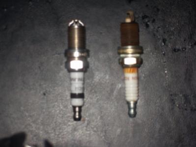

So changed out the spark plugs to Bosch Platinum+4 Spark Plugs
and it seems to be running smooth for the most part. I gotta tell you that this took me about 2 to 3 hrs. Lasttime i did plugs was on a 4cyl sundance and i striped the threads on 1.
Umm....you will be replacing those soon also. NGK is the only plugs recommended for the VQ's..
