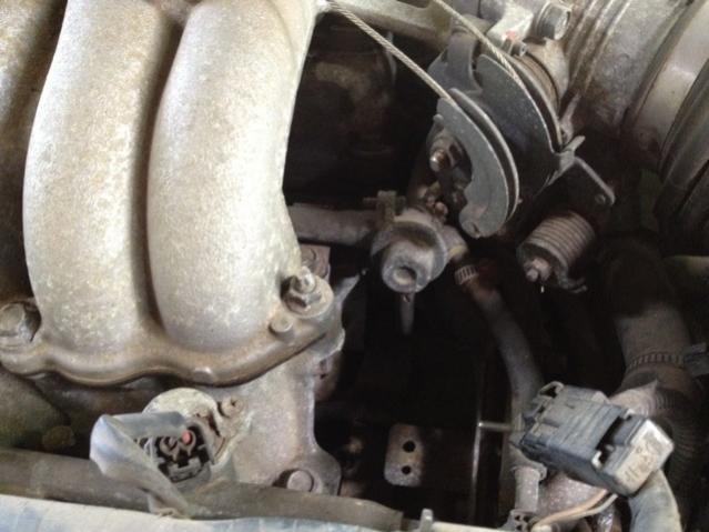

Also since I cannot start a thread I will post here, I cannot find what this vacume operated valve is in my Haynes manual is, it had a hose leak but just seemed to effect idle. Anyone know its purpose in life? It's the round valve with the split hose coming up from bottom of valve.
