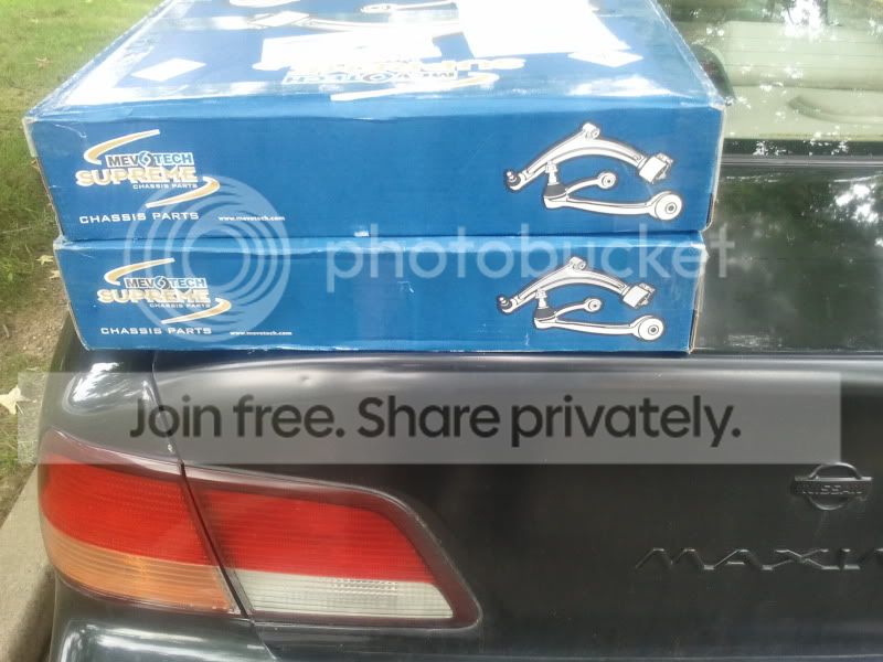

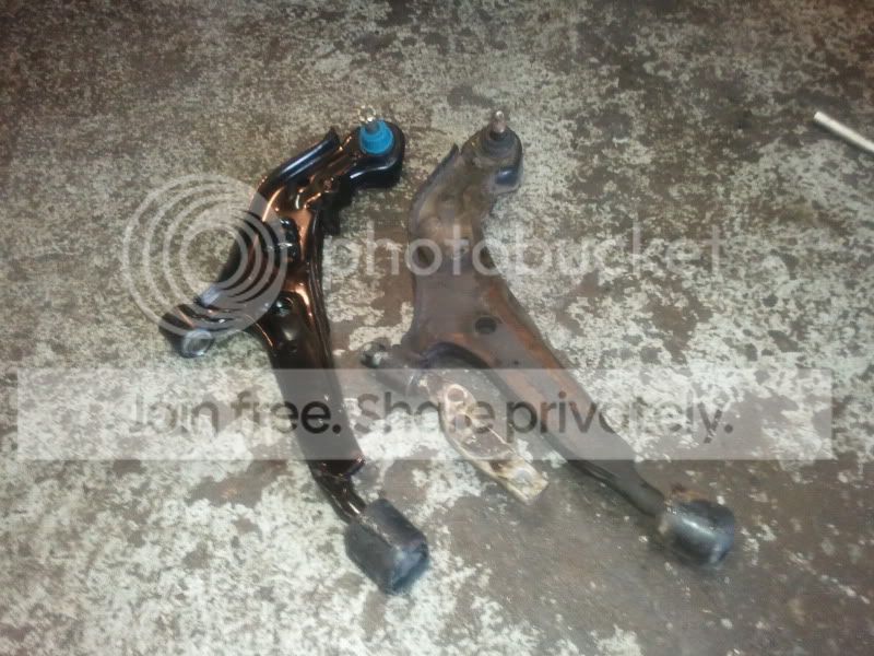

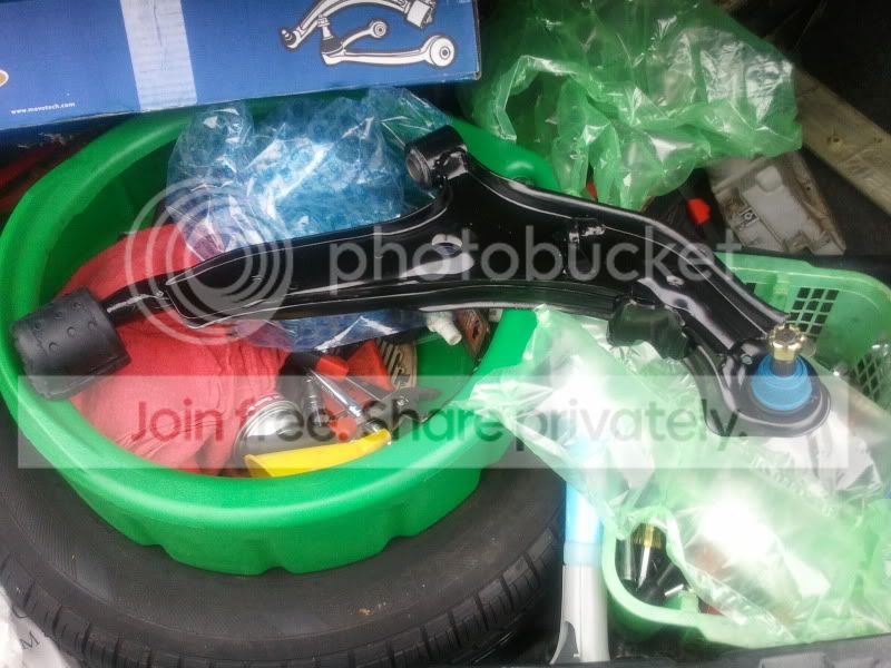

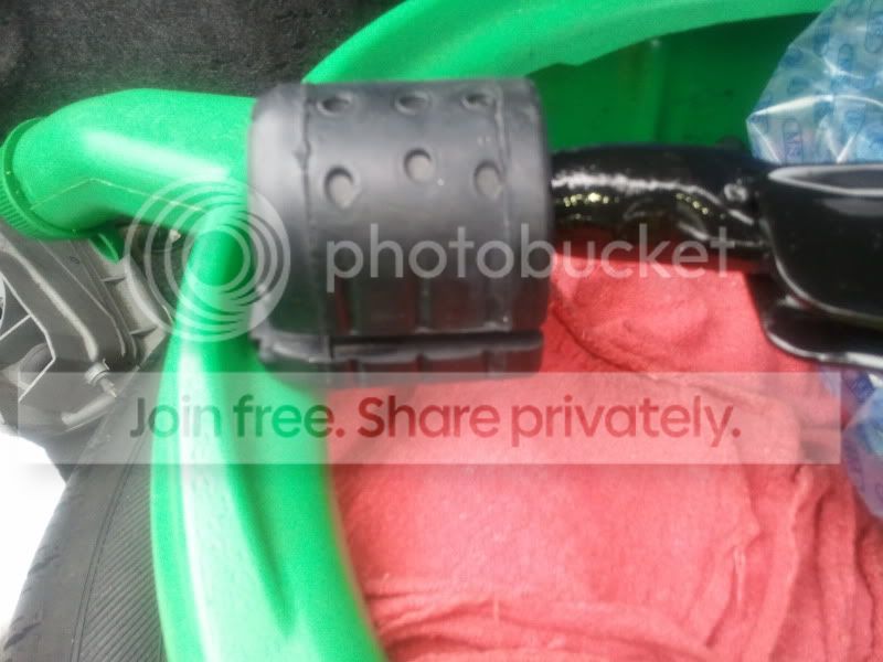

OK so i got the Mevotech control arms for a few more bucks and i thought installation was going to be kinda easy until I discovered the Mevos are missing a piece the old stockers had, take a look at these pics!

also, the mevo unit is not missing anything, your suppose to remove the old bracket and install on new. that is an OEM peice only.

They aren't missing anything. That silver piece with the 3 holes is the pivot shaft and is a separate part. Some people have had trouble getting the pivot shaft out of the control arm bushing in which case you could get new ones.
