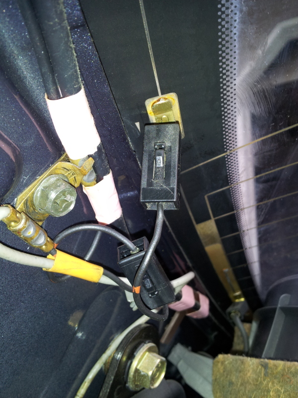

Alrighty then, boys and girls:
Connecting the gray antenna out of the keyless module to the window antenna isn't hard...just requires rear seat removal. The plug is indeed in the passenger side c pillar...
Got a good 100 foot range now
The only potential issue is that the radio was plugged in there
but driving around yesterday with radio on wasn't too bad, reception wise. Will probably rig a y cable so I can connect BOTH to the window antenna but it's not bad right Now

I was able to create a y cable for each antenna end and now I have my radio and my keyless entry both working flawlessly! Check it out:
the way it works is that the female ends of the current radio antenna and keyless module go to the 2 male ends of that cable...and then that female end of the cable plugs into the male end of the window antenna.
FLAWLESS BABY
