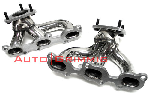

If the headers look like this then I wouldn't bother.
I had a set of these generic shorties a few years back, only installed the y pipe that came with em. They were initially 1/4" off and I had to spend some time with a hammer and crowbar to make the y pipe fit on my stock exhaust manifolds.

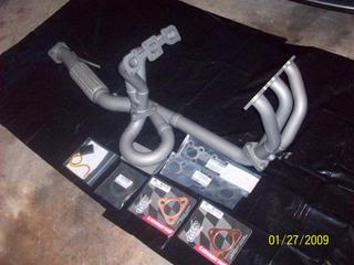

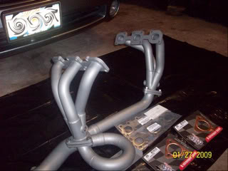

Oh yeah, I forgot to mention 95-99 and 00-01 are compatible and a perfect fit all have EGR port provisions where as 02-03 don't have any EGR provisions.....like these:
