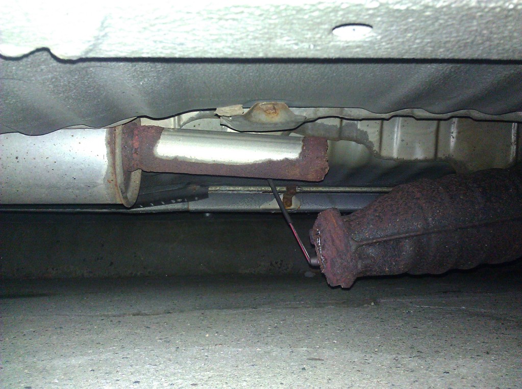

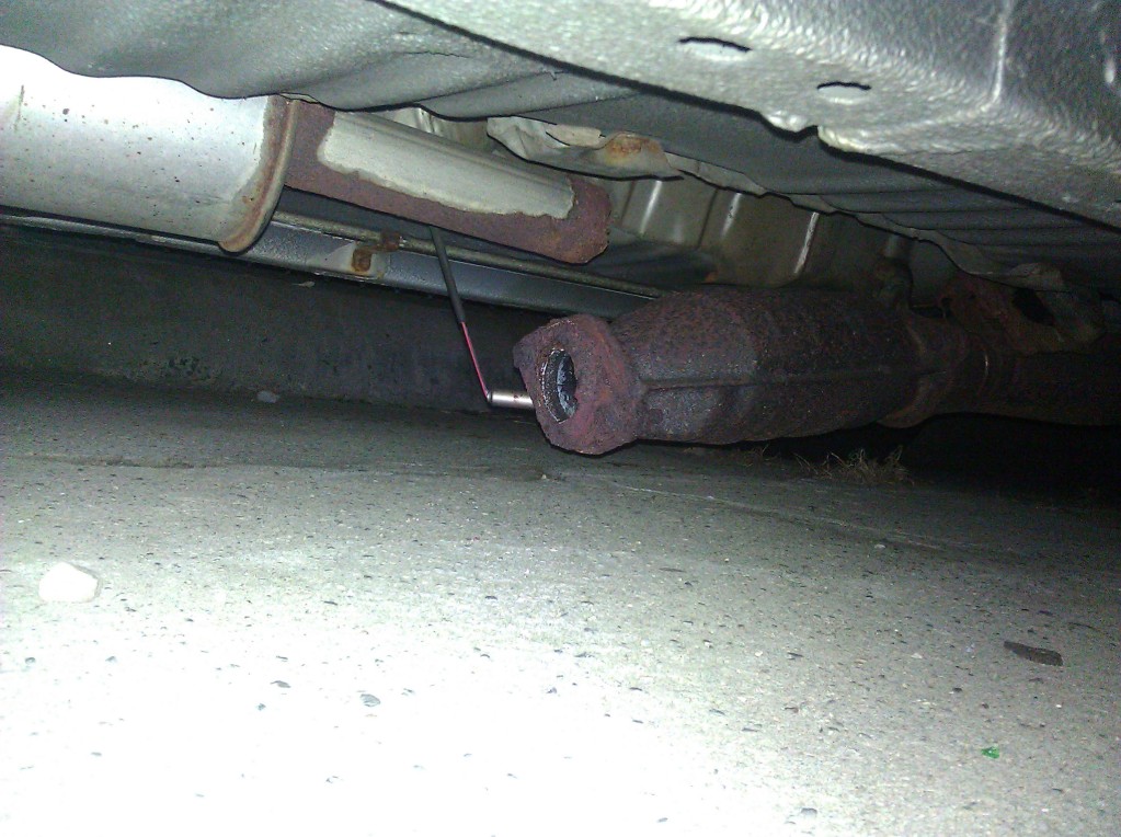

About 3-1/2 years ago, I had a bunch of work done on my '95 GLE's exhaust system. It was my understanding that pretty much the whole back half was replaced, so I guess that'd be everything after the catalytic converter, right? Last month, my car suddenly started making a very loud noise while driving. I saw that the cat was hanging by one end, so I took the car off the road as soon as possible. I only just last night had a chance to get a good look at what was going on, and it appears that the pipe has rotted and sheared off right at the point where it meets the cat.
These pictures are taken from next to the rear wheel, pointing toward the front of the car:

I have a friend coming by today to see if there's anything we can do as a temporary fix, but what's the least expensive safe way to fix this? Can anyone recommend a part? This came up when I searched autozone.com for parts for my car, is there any reason I shouldn't go for this? http://www.autozone.com/autozone/par...280429_0_1002_

Looks like a cheap Walker pipe. Mine did the exact same thing about 3+ years into it.
The correct fix is to replace the B pipe or you'll be chasing failures at each weld as time goes by.

Same thing happened to my car... salt sucks.
I'd personally replace it with the lifetime warranty bosal for ~$150 if you can afford it.
Just make sure you also buy the 2 flange gaskets (if you hadn't already taken them into account).

Those bolts on the flange look like they'll be a ton of fun to get off. Is it likely that I'll need to replace the catalytic converter, also?
And perhaps the most important question...other than the noise, is there any danger in driving the car in this condition? I've had it off the road for over a month now, because I haven't been able to spare the cash to fix it, and I'm getting frustrated not having my car available.

U can drive the car fine like this. But, as shown in the pic, everything is jus hanging so u may want to try somehow to prop it up

I drove my car around with just the catted y-pipe for about a year (had literally no money to fix it and no alternative, didn't want the cat to fall off so I got it off of there). The things you'll want to watch out for is the added stress on the flex section with the cat hanging like that and the stress on your oxygen sensor wire since that's keeping your cat off the ground.
I don't recommend driving around like that because some police target louder-than-usual cars, but if you've got no other choice be extremely light on the gas anywhere near police.

Cracking tends to happen at the site of a poor weld (too hot of a weld?). Add to that rust weakening the metal and heat cycling.
save your pennies and get SS if the car is worth it.

From the looks of it u gonna need a new cat. If not now, then soon man cuz that thang is rusty lol.
U can do the magnaflow hi-flow cat. My boy has one and was able to pass emissons with it.
For the rest of the exhaust, looks like u gonna need a new test pupe along with Bpipe as well. Try to finda SS catback from ebay and make sure it comes with a resonator and silencer for the muffler so u pass MA Inspection.

Unplug that O2 sensor before u lose it. Time for a y pipe and cat.

Damn that is some crazy rust, ebay has stainless steel exhaust, you can use the B-pipe and just use your stock muffler if you don't like the cannon look...

Do the work yourself and replace the cat and b-pipe. IF possible, before putting it on, paint it with the same high temp paint that toyota and honda use on their exhausts as this makes them last much longer.
