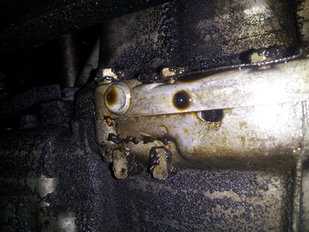

Hey 4th genners,
I have been around on these forums for quiet some time but I've rarely posted. I think it's because I always thought I'd rely on a mechanic. Now, I'm trying to become more active in the maintenance of my own vehicle. So I need some help and I brought pictures because I love pictures and people here love pictures. So these are my problems. Any advice on any of them is great.

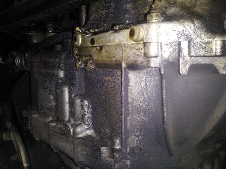

(1)Very Slow Transmission Fluid Leakage (I think). I had an Oil leakage before and it could be that but I fixed that last year and I've since had multiple snow storms and car washes.

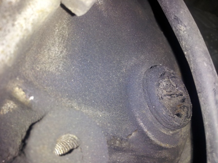

(2)How the heck do you get access to the filler plug of the transmission? I've tried a 1/2" racket and it's stuck together quiet well.

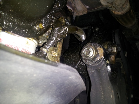

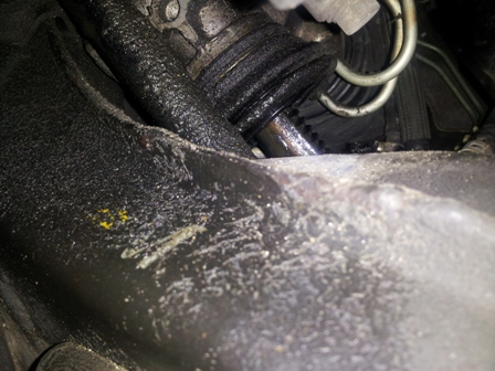

(3)Above center... The metal bar with teeth is the rack assembly shown through a broken bellows boot. I can get the parts and fix the boot but I want to know what grease and lubricant are recommended for the boot and for the rack assembly so that it doesn't dry out. I do NOT have power steering issues that I'm aware of. My car makes moaning/creaking noise when I turn deep left every so often but not every time. This could be because of wheel bearing or suspension not sure. Can I use WD40 as a spray-on lubricant for the rack assembly or can I just leave it alone and let the Power Steering Fluid handle the rack assembly?

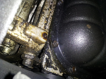

(4)Remaining oil leak I presume?
Please ask questions and more importantly provide feedback. I'm a novice at car repair but I'll take any advice and constructive criticism necessary to learn.
Thanks, JA.

Looks to me as if the last leak is probably a rear main seal leak as that is where the oil drips to the ground from when you do(pass. side). This oil leak is VERY difficult to get to and fix and im getting a bargain from my mechanic who is charging me $500 to do it. It about a 2 day job for sure. With the rack boot torn, repair that IMMEDIATELY or else you will have to replace the whole thing. In reality you should fix the oil leaks first because no matter what you replace, if the oil is still leaking on it, then it will deteriorate again and break. Im not sure its the rear main seal, it could be as simple as the oil pan leaking. If you clean up the area with degreaser then you can more easily tell where the leak is originating from. Oh and the FSM recommends NLGI no.2(lithium soap base) as the multi purpose grease of choice. Any litium soap base should do though. No WD-40 wont work on car mechanical parts because it simply drips off. Its not thick enough to stick and stay like grease is. GL and post back about where the oil leak is coming from

Get brake parts cleaner, and clean off all the surfaces as best you can. Get like 6 cans of Brake cleaner. Put some cardboard underneath where you're cleaning, because all that caked-on dirt and grease and oil will drip on the ground a leave a stain.
After you've cleaned off with brake cleaner, you'll better see where the leak is originating from.
The boot you'll have to replace. Or have it replaced. From what I understand you'll need to take the wheel off, mark where the outer tie rod end link is screwed onto the inner tie rod, disconnect the outer tie rod end link (pickle fork), remove old boot by removing the clamps that hold the boot ends, put new boot on. You might need to remove the inner tie rod too, I am not sure. Someone else has to chime in. Probably will need an alignment if you don't put the outer tie rod end link on the tie rod as you found it.

You can also get "engine cleaner" from your local auto parts store. You spray it on, let it sit for a bit and then hose it off. Just be sure to hose ALL of it off...that works really good.
For what its worth, my engine looks exactly like yours (in concern to the oil leak). Ive got 219k and burn/leak about a quart of oil every 3k miles. The best way to diagnose where it is coming from is to clean it like previously suggested, change the oil and add some florescent die. Then you can use a UV flashlight and it will glow where the leak is coming from.
As far as the fill plug is concerned....PB Blaster....then a large dose of "PUT SOME EFFORT INTO IT!!!"
If it sticking real good, you can use a "motivational tool" (i.e. Hammer or 2ft piece of pipe to stik onto the end of your breaker bar for added leverage). Just be sure you are going the right way with it and not actually tightening the bolt!!!! It will come out, but may just take some added "motivation" to do so lol

The first and last set of pictures show that the upper oil pan half moon seals are work and need replacing. You would have to undo the lower oil pan to get to the upper oil pan to reseal.
As for the middle pictures with the teeth, that's just the rack and it shouldn't be heavily greased. It looks fine from those pictures. As long as your inner tie rod is good and not moving or loose, just replace the boot. Otherwise, replace the tie rod with the boot and you should be fine.

About the filler plug......just put some extra force into it. Put some muscle into it

UPDATE: I purchased the following at Advanced Auto Parts:
Beck/Arnley Steering Rack Boot Kit
and got it installed for $143 (~$60 alignment) at a shop. I'm going to get a car wash on Friday and do some fine cleaning of my own afterwards. I'll post updates. Thanks for the suggestions and support.

The fluid on you tranny case is engine oil. ATF is red. Engine is brown/black.
Like others have stated, clean the area thoroughly to determine where the leak is originating.

It is the upper oil pan half mon seal. There is one on the opposite end under the crank pulley. If yours is leaking from there also, its the same on the other end. You have to disassemble both oil pans and reseal. There is no other way to fix it. I tried to shortcut and it does not hold up.

Another Saturday of Blood, Sweat and Pain but I cleaned up the base of my transmission. I applied the PB Blaster to the Filler Plug and it still would not budge. I replaced one of my rear brakes and now it's quiet. I am running out of ideas for how to open the filler plug. I may need an impact wrench. I couldn't see where the leak was coming from but it was definitely a brown fluid. So, unless my transmission gear oil hasn't been replaced since the car came off the lot (which is possible) and the transmission oil burned up, I'm thinking it's motor oil.

Use a flat tip screwdriver to clean out the space where the socket fits for the plug. If the ratchet actually fits, then just buy a breaker bar. It will come loose. I keep a 36" breaker bar in my trunk. It's way better for tire changes anyway so it's a good investment anyway.

I finally got the Filler Plug out of the transmission. The tranny fluid is as brown as the motor oil so I'm going to drain and fill. The mechanic shop told me my fluid level was okay (which is true) but they didn't tell me it needed replacing. They probably wanted me to run into transmission issues
