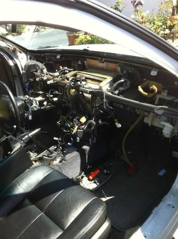

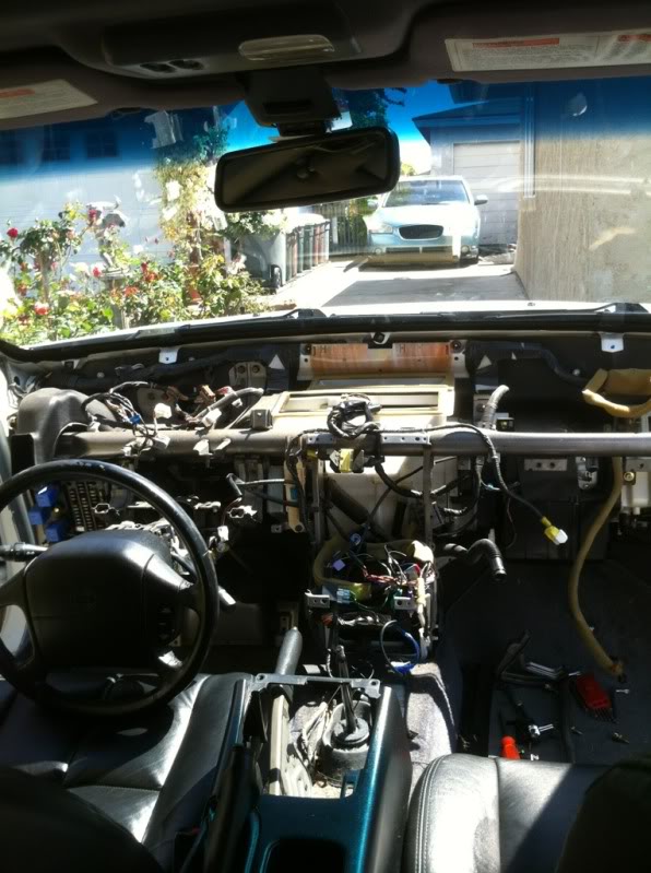

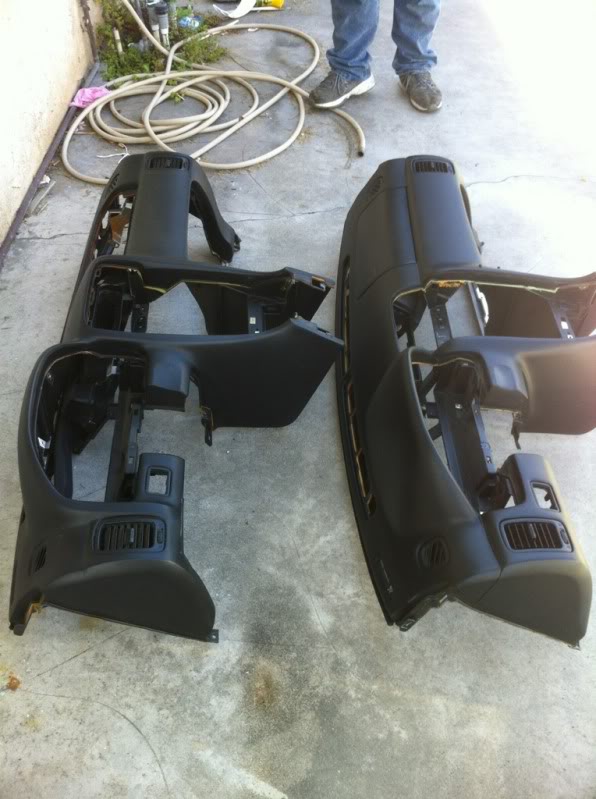

For reference purposes
Stock on the right i30 on the left
Dash removed
The i30 dash as an extra piece of duct behind the ac vents to line up with the center of the dash where the air comes out, what's weird is my vents by the doors don't seem to be affected

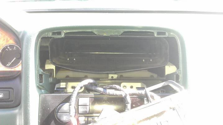

OK, I just pulled out my center vents and found something.
The harnesses for the hazard lights, defrost and clock were wedged between the plastic duct and the vent trim piece. There was a pretty good sized gap just dumping air out behind the dash.
This might explain why on really humid days my AC vents would have condensation forming on the outside and even on the buttons.
The plastic duct has been warped from being like that for so long, Im going to have to put a little bit of foam weather stripping in to fill that gap.
