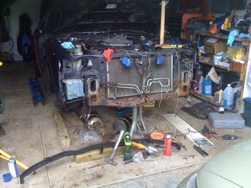

Gang, I may have some very disturbing news. I took my second 4th gen to get the lower support replaced and examined the one that was removed and it seems that the previous owner already replaced it with an OEM one. It has the third plate in it and it still rotted out. This is very disturbing as it is rotting from inside out. See the pics below..
Right now, I am thinking of a way to prevent this from happening again...

I don't believe salt is the concern. water is going inside and staying in the middle of the support and not finding its way out.

What I am thinking of doing is spraying liquid foam inside of it from the drainhole in the middle of the support and let it fill out the entire inside of it. The body shop painted it already but I been thinking about this for a while and liquid foam is my best bet.

Eastwood.com has a frame rust prevention coating and converter that works very well i used it after i did the support repair and mine will never rust out again i used 1/4" steel plates to replace the support and stainless hardware

When I installed a new OEM lower radiator support earlier this year I sprayed on several coats of rubberized coating on that new support. I also dropped the crossmember bar and t-bar and after wire brushing them I threw on rust converter and rubberized coating. I had thoughts of clogging the holes on this new support but I'm sure the rubber will keep it safe for several years.
If I ever see rust developing down the road I'll just touch it up again. To access the lower radiator support you just need to drop the engine shields and remove the bumper.

Well what I have already done is cut off the front half of both engine splash shields so no water sits there that mayhelp corrode the support from rainwater.
