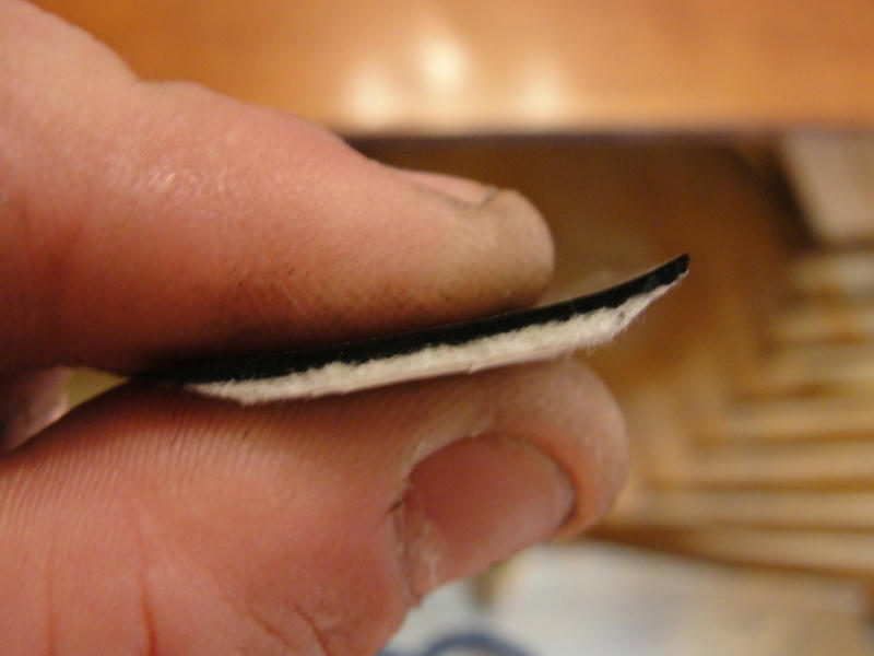

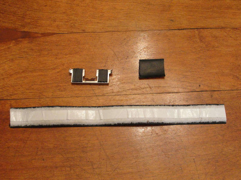

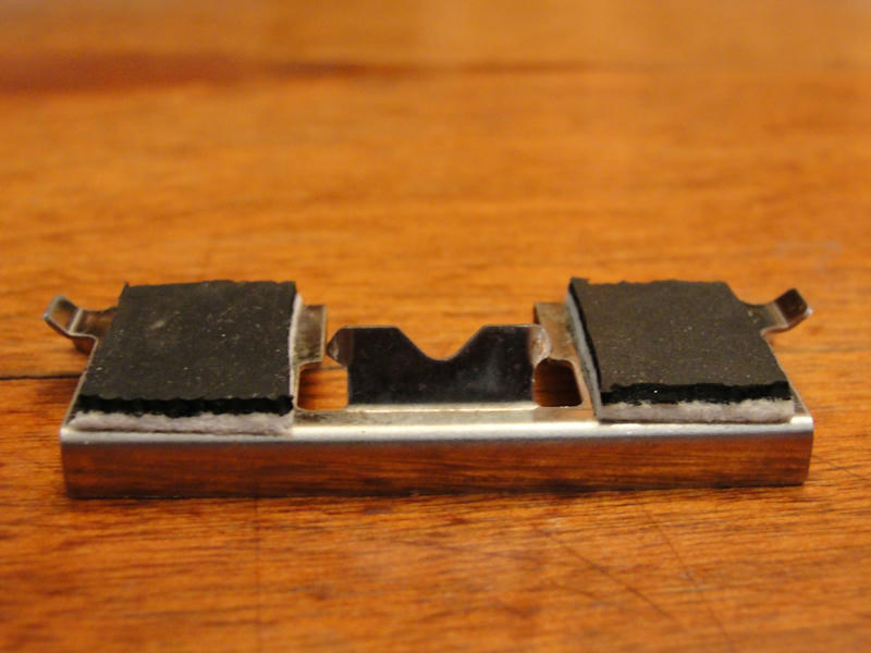

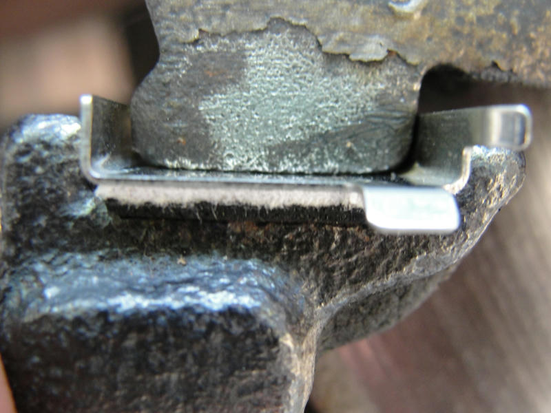

In lieu of rubber strips I was able to find some self-adhesive tennis grip tape that I cut into two equal sections. They stick very well to extremely clean retainers.
The grip tape turned out to be a little too thick to do both retainers, HOWEVER even with just one modified retainer installed, the pads now essentially have zero play/movement. The difference is like night and day.
I don't have time to do the mod on the other wheel this morning, but after I put the calipers back on the car I'll be sure to post my results.

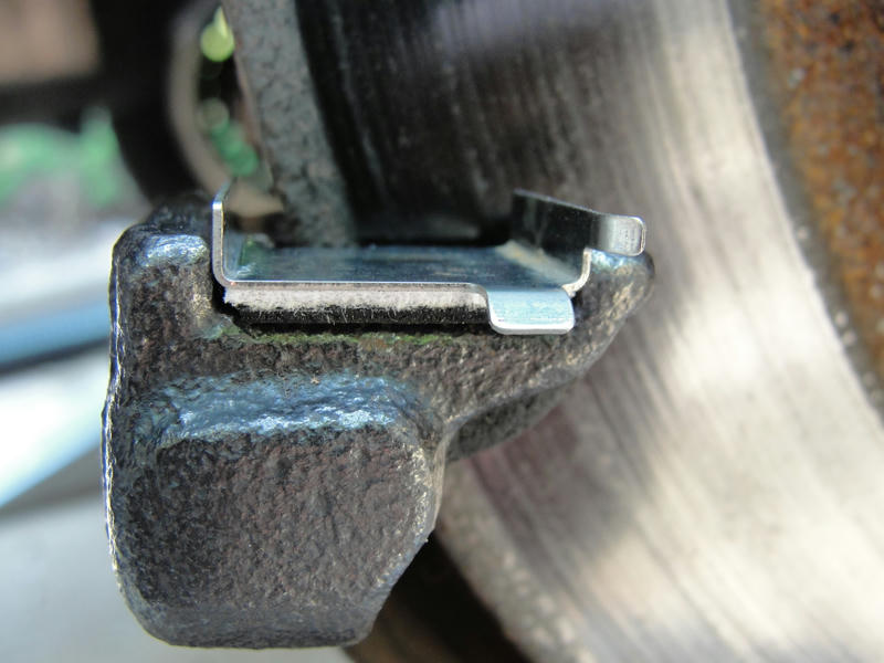

Here are some pics of the materials I used, the retainers after the grip tape mod, and how the retainers and pads look after installation.

Update: Took the day off, did the same mod to the other wheel: NO MORE CRASHING!!
I hereby declare this as an incredibly cheap and easy modification to eliminate (at least temporarily) that embarrassing 4th gen rear end brake pad crashing. Keep in mind I have only driven 15 miles since doing the mod so I can't tell you how effective this mod will be in the long run.
For the test drive, I specifically drove on roads with poor pavement and/or bumps/potholes with the windows down and the radio off so I could hear even the slightest bit of rear-end rattle. There was NONE.
For those of you willing to do this fix, I used an extra-tacky non-perforated Babolat tennis replacement grip (not sure of the specific model), you can find this at any Sports Authority (where I work)/****'s/etc., basically most sporting goods stores for about $6-$8 dollars a roll.
Make sure you get a replacement grip that is self-adhesive and slick, yet tacky on the surface (no holes/perforations). DO NOT use super-thin non-adhesive overgrip, it is about 1/3 the thickness and will be very difficult to align underneath the retainers without some sort of glue/epoxy, plus it doesn't have any sponginess to it so it won't actually apply any sort of upward pressure against the pads.
FINALLY I no longer have to grab the E-brake while driving through my neighborhood to avoid those WTF second-takes as I drive by.
It's time for a beer, or three. PM me if you have any questions and I will most definitely be posting updates regarding the longevity of the fix.
Mini-update: Glad to say that after 200 miles over 3 days the "grip-tape fix" is holding up perfectly, no crashing/clanking whatsoever. I know the 5.5th gen part-swap thing is best way to permanently correct this problem, but this has got to be the fastest way to eliminate the noise without buying anything except a $6 roll of tape.
If anybody here does this mod, please let me know about how it worked out for you, thanks for all the help guys!

TL;DR: This fix works. Go get some grip tape.
Also the tennis replacement grip shouldn't be viewed as a "tape". There is only a very thin layer of adhesive on the sticky side of the grip, probably a fraction of a millimeter thick.
I went into this assuming the sticky side would only serve as an easy yet temporary way to attach the grip tape to the retainer clips for mounting onto the torque members, and so far it's more than served it's adhesive purposes.
Even if the sticky side of the grip tape has lost it's adhesion, there is still plenty of added contact between the retainers and the pads due to the durable sponginess of the grip tape.
