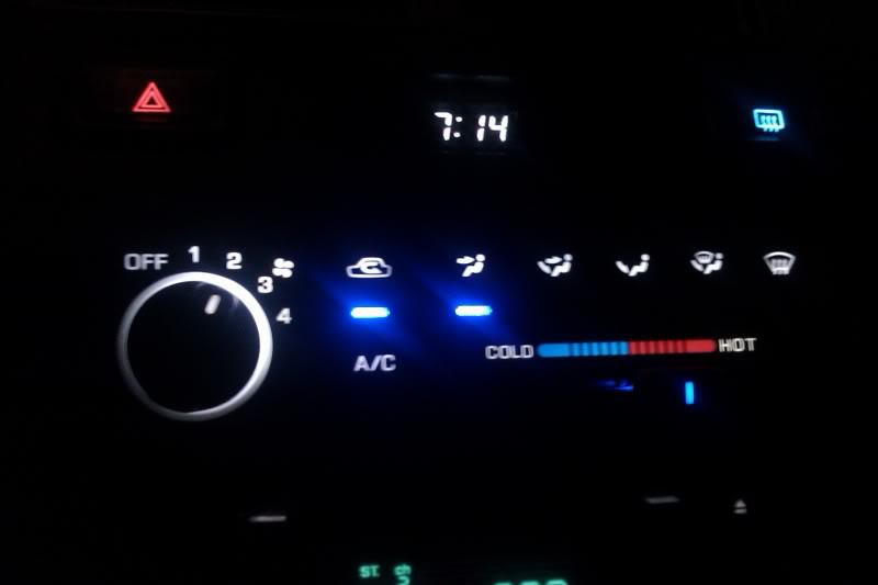

Go blue interior:
http://forums.maxima.org/8392420-post57.html
With your '95, any 360* led that has a 194 base will work, AND give you zero hotspotting..how do I know? I got them for my wife's Outback (and father in law's as well). Go to superbrightLEDs.com, the type you want is this:
WLED-xHP5: LED T10 Wedge Base Bulb
^^That's for your cluster, and available in 6 colors. Plug and play baby!
Doing the backlighting for the LED climate control could be a bit more, involved...but well worth it! You can customize not only the backlighting color, but the color of the individual LEDs themselves...
Don't forget window switches!

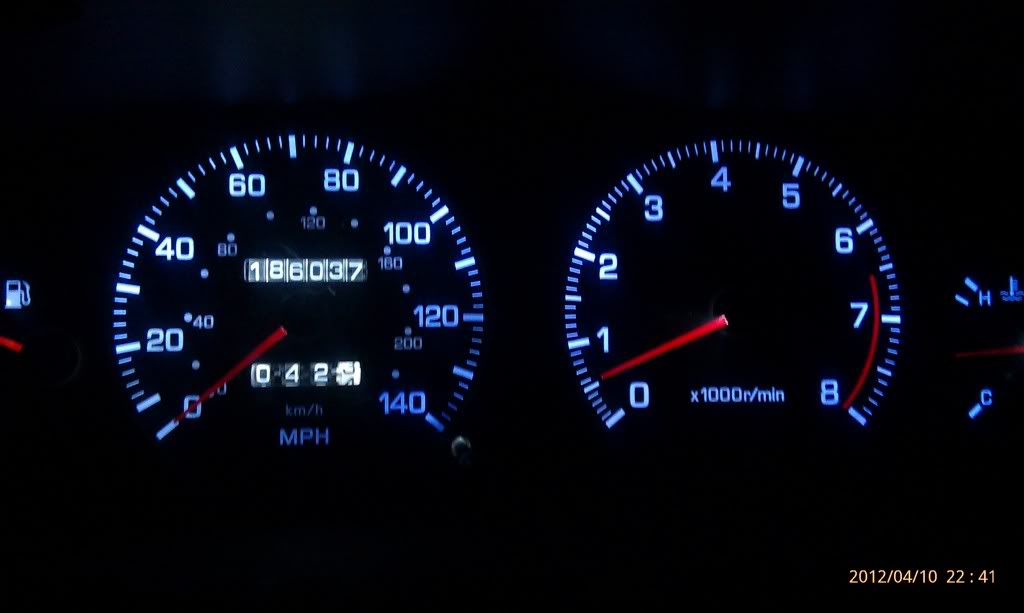

I would take your cluster out, put the cool white bulbs in like Amerikaner said, and use a red sharpie on your needles to change the color and call it a day. I think that would look the best...but I'm bias since that's what i have in mine
Edit: I left the factory white on the underside of my needles and put the red sharpie on the top that way I didn't have to take the needles off. Here's my pic. Looks better in person but you get the idea. The needles originally looked exactly like yours.

Old Jul 5, 2012 | 07:19 PM
EvoTillIDie's Avatar
Posts: 576
From: Maplewood, NJ
ALL DONE!
This was by far the easiest mod ever! Thanks to everyone on the forum! It truly is a P&P! Up next is the window switches!!! Anyone care to educate me on that also?
BEFORE
AFTER
Kind of did a bad job on coloring the needles : / but I think they should be alright lol

Did you use red marker on the top side of the needles? If you want to do it again, I used the red marker but just "dotted" down on the needle instead of using it like normal by going back and forth cause I noticed that dotting seemed to cover better. Looks good though! And for your window ones, contact amerikaner83 or look thru his thread here http://forums.maxima.org/members-rid...-progress.html I know he did his, just not sure if he wrote about it in his thread but I'm sure he can point you in the right direction for a write up etc. Good luck.
Also, are you going to led your heating/ac buttons? Do you keep your speedo cluster lights fully bright or do you dim them? I dim my speedo cluster ones but that also dimmed the heating/ac lights to where I could not see them and i didn't feel like putting leds in...so, I did a mod so that the heating control lights won't dim with the switch. Let me know if you want the link to that write up.
Edit: here is my write up http://forums.maxima.org/4th-generat...sible-how.html post #20 has the actual write up.

Yes, for the window switches, it's a bit more intense, but completely doable if you have basic soldering skills. The only problem ones are the rears, as you are replacing a SMD LED (surface mount) with the "regular" bulb-looking one.
I am having trouble finding the site that I used as a writeup for mine, but it's pretty self-explanatory: pop off window switch trim without breaking (pry from rear/front), remove screws holding housing to trim, pop 4 tabs holding housing, flip housing upside down and slowly remove the PCB and switches...note orientation of the LEDs currently and replace with your 3mm LEDs in same polarity orientation.
Lemme see if I can find it for ya.
edit - FOUND IT! silly me, it's in the how-tos right here
http://www.cardomain.com/ride/479058...-maxima/page-3
Scrolll halfway down the page for the 4th gen writeup. He lists a dremel as required, it's NOT. Only if you got teh big 5mm LEDs, and you shouldn't. The 3mm are plenty good. The writeup is listed for 98-99 maximas, not sure if it's exactly the same as yours, but it's probably pretty close.
Do you want to stay with blue?
