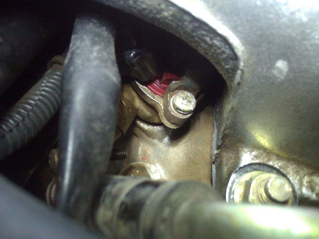

Hey org. Just several days ago, I replaced my fuel injector for cylinder #1. I've got my power back and everything seems to be working fine. I was driving around today when I noticed that I started smelling fuel. I finally found the source tonight when I got home. It's where the fuel rail goes into the block for cylinder #1. As you can see in the pic provided, there is a wet spot on the motor block surrounding the fuel rail. I don't know if I managed to damage something with all the tugging and pulling when trying to remove the original injector.
Do any of you fellas have any ideas? Thanks to all in advance.

Replace o- rings if you didn't do it when you changed out the injector and that should solve your problem.

This isn't good at all-I had the same issue on cyl 6 a few years ago. The oring basically either disintegrated or whatever, and the fuel injector was basically dumping/pouring fuel into the cylinder resulting in a cylinder lock! Also, exposed fuel=never safe! Especially in an engine bay!

I vote for damaged o-ring seal.
