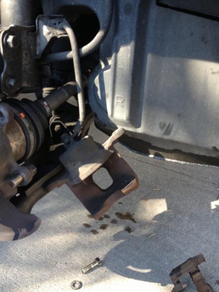

How much should someone charge to do just R&R on timing chain and front main seal?

Looking for nissan mechanic around the Austin Texas area-image-2429181013.jpg
Old Nov 16, 2012 | 05:33 AM
CMax03's Avatar
Posts: 9,587
From: Houston, Tx
That can be the rear valve covers, PS hoses, oil filter, crank seal (but seems to far back to be the crank seal), I could do that timimg chain assy/crank seal all in one weekend but you're looking at about $600 labor.....I'm from Houston! Do you have all the parts necessary to do a timimg chain R&R?

I have replaced value covers and the leak is all over a guy check it out and he said it could be the front main seal it's defiantly leaking from the lower oil pan and the TC he's charging $869 R&R but I'm trying to get a way lower price I'm willing to do all of it I just don't have the space nor the tools

wow. I wish my oil leak was that small.

That's just a new parking lot my drive way shows a whole different picture

Why not jack that BtCh up at the car wash and spray that entire engine bay down.....and then do a leakcheck!

Replace the O'Ring for the CPS sensor, Check your Valve Cover Gaskets just by running your hand along the back of the Head's, and than spray down the Front Main Seal with a cleaner and see if the problem persists.

Open your hood and examine your timing chain cover where it meets your heads. If you don't see silicone there, it may be your rear timing cover o-rings.
