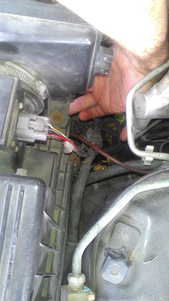

Weird thing happened. My starter died a week ago and when I got it push started my maxima triggered the CEL.(Happens everytime I get it push started) I replaced the starter and got the codes checked at Advanced Auto
UPDATED with codes:
0401- intake air temp sensor can anyone point me to where this sucker is?
0304-knock sensor (host code)
Ill go back tomorrow and write down all the codes.
Are any of those in the way of the starter? Im hoping i left something unplugged. The Car still runs and drives fine so I'm not too worried. I checked and couldn't see anything out of the usual. Can anyone point me in the right direction ? Thanks

BUMP just checked the codes. dont know whether to be happy or what because the OBDII computer showed 2 codes and when i checked manually I got only 2?
cant anyone show me where the intake air temp sensor is ?
noob/10 lol
Follow the plastic tube from the air box toward the front of the car. It will be in this general area Name:  IMAG0277.jpg

The photo shows a connector with a red wire. That is the intake air temperature sensor.

Thanks everybody. I knew I was missing something. On my car (97) its on the snorkel that feeds air into the airbox. The sensor had fallen and was just lying on the tranny.
Plugged everything back up and reset the CEL.
