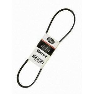

The two belts are brand new:
Gates K040305 Multi V-Groove Belt
Gates K060431 Multi V-Groove Belt
Since they are both new I will just adjust them both tomorrow. The noise should go away on its own.

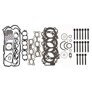

Gasket kit ($87.99) I used while doing the valve job:
Last edited by delacruz_17; Jan 17, 2013 at 08:30 AM. Reason: Added info on the gasket kit I used while doing the valve job.
