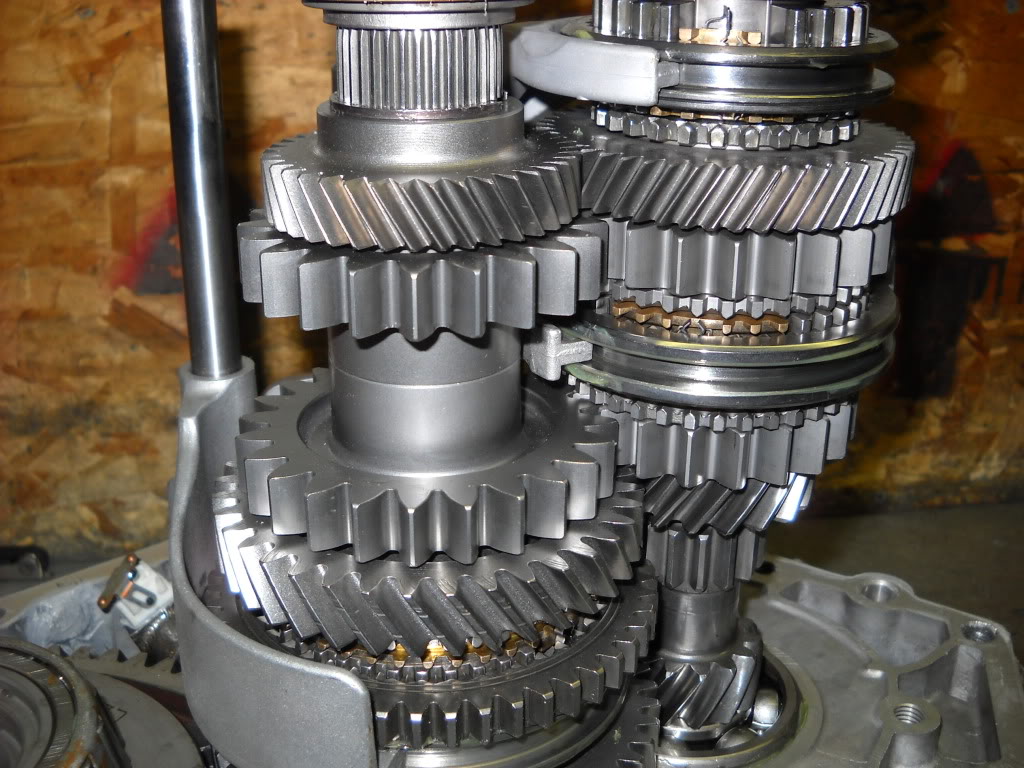

the rocker switch is visible in the lower left corner of this pic, in the background.

It might fall out but trust me you won't be confused as to where it goes. There is only one visible place. There are two little pegs on the rocker switch and you will clearly see the corresponding wholes right away, pretty much the only thing you can see since it sticks out slightly.
Edit: holy crap that is the cleanest transmission I've ever seen! Is it brand new?

I did to replace shot bearings. It's a PITA for someone without a real shop to work in with lots of nice tools, but as a diyer it is doable oh and I noticed the straight cut third and fourth gear. How loud is that thing?
it's moderately loud, definitely noticeable but when i'm WOT my loud 3" exhaust drowns it out (inside the car at least, I'm told that outside the car it sounds like i have a roots style supercharger on it). when i'm off the throttle decelerating in gear is when it's most noticeable inside the car. 3rd is a bit quieter than 4th.
it's a little louder than the gears in this video, but his car is quieter so you can hear his pretty clearly (this is a 350z trans i built for my best friend with gears i prototype tested for PAR, this was the first set of these gears in existence)
