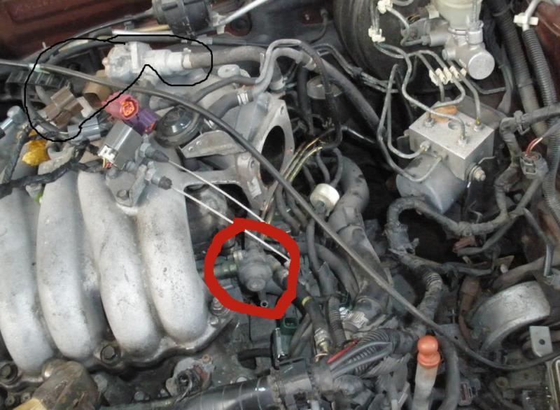

[QUOTE=DennisMik;8728641]The P1445 is the valve on the charcoal filled EVAP canister that is behind the driver's rear wheel. There is a plunger inside the valve that gets stuck from all the road spray from the tire. Sometimes you can free it up with WD40 or similar and sometimes you gotta get a new"
P1445 is the purge valve located on the top rear of the intake manifold, it has hoses attached to it, a one big brown connector, it's not located behind drivers wheel well, this is wat the sensor looks like
It is on the top left in the pics silver Sensor with a brown connection
P0100 will cause hesitation, won't allow you to pass over 2500 rpm, and causing to shut off this is the maf sensor
P0325 is your knock sensor located under the intake manifold

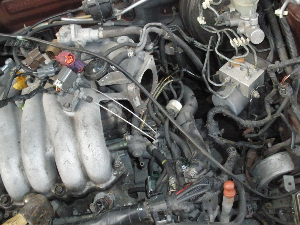

P0105 is your map sensor, normally this is hooked onto the air intake tube with a 10mm bolt, it has a single hose running into it, it looks like this, if you look to te right of the v6 3000 cover you will see tied into the
Intake tube

Since you have, or will have all those parts removed like in the picture, then you may as well replace the FPR. It's fully exposed, and from that Pic, looks oem, so it's probably very very tired. It may not be troublesome just yet, but it will be soon enough.

FPR? & that isn't my engine bay lol

Fuel pressure regulator (highlighted in thick red).......
