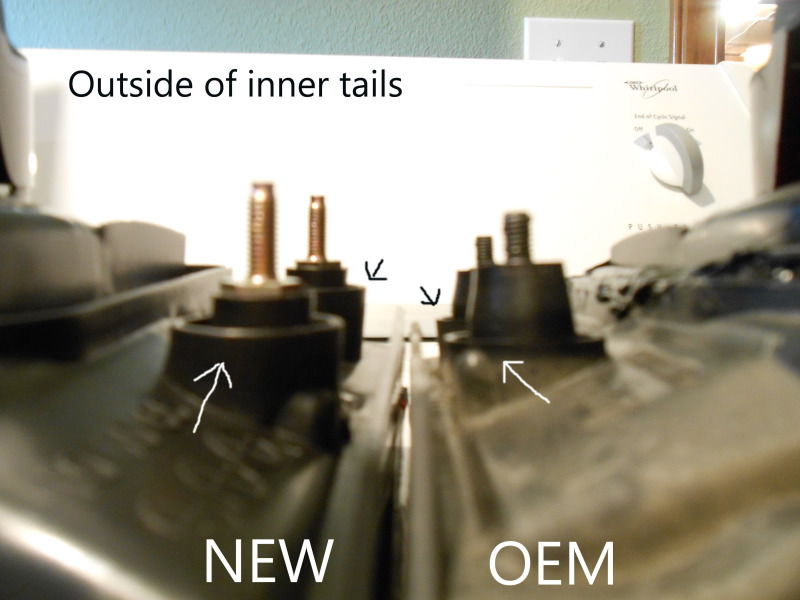

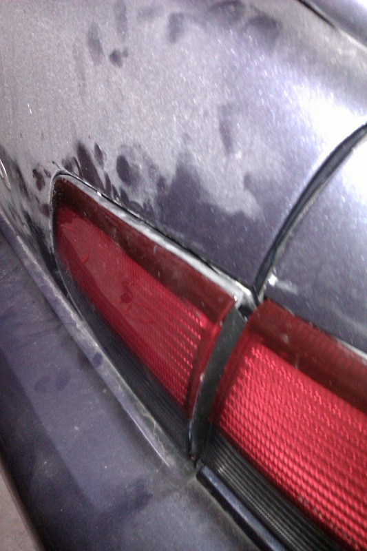

I've got my OEM 97-99 tails if you want 'em...50 bucks and they're yours. And they're super easy to install, just need a big flathead screwdriver for prying, and a heat gun / blow dryer for heating the adhesive up.
IF you go aftermarket red/clears, you WILL have to do a bit of fab work to get the inners to sit flush, just an FYI. You'll need new nuts for the inners as well
