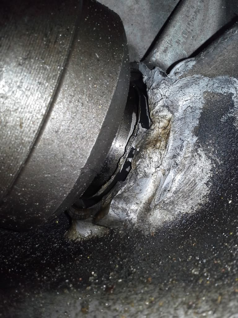

WToday was slightly disturbing. I actually found something that I had never seen before and frankly, makes me want to repair some things just to make a quick profit by selling the car .
That is the driver side axle seal. If it's hard to see on the pic, let me explain. It's got a fairly good looking axle seal. The housing looks like a chunk of it around where the seal seats, was broken and then a repair was attempted with quick steel or jb weld. I knew I had an axle seal leak and I knew it wasn't caused by diff bearings. But Now I almost wish the bearings were the cause, at least that's a repairable issue... This may require a new housing altogether. It's really disheartening considering my overall goals.
Any and all advice on this matter would be greatly appreciated.
One other picture of that seal can be found in my photobucket album (link is in one of my first posts) as we'll as new pics of the lower radiator mounts although I could not get a clear pic of the support, I was able to physically see that it was ok. Also, rear valve cover is not leaking, which is great. the cause of a p/s leak was discovered, and I think it's probably the spring clamp on the P/s pump hose as well as the copper washers on the pump banjo bolt.yay!

thats pretty crazy, id reccomend swapping out the transmission. that case is junk. source one from a wreckage yard or something. idk man thats a pretty nasty chunk. have you checked the gear oil levels? that looks like it could leak pretty tenaciously.
