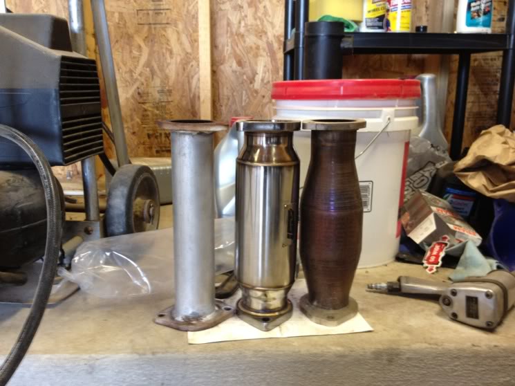

I'm using a test pipe from an S14.
Originally Posted by LONDART
A high flow cat is not factory...they're universal weld-in so length of that was obviously made up by cutting either y-pipe or b-pipe before welding together...welded because it doesnt have the factory flanges
All Nissan specific (non stock) HFC's or test pipes have the flanges to fit our cars, and most all Nissan cars, and are the proper length.
Right: Test Pipe 2.5", Center 3" S13/14 test pipe, right, HFC. None are stock.
Some test pipes have flanges that are not welded to the body of the unit, so you can rotate them as needed.

Might be like the megan test pipe. I couldn't get that thing to fit to save my life. It was 13 5/8" also.
Stick with the 12" or so.

Yeah, the test pipe on the left of my picture was on my car for some time and I sold it to a 4th genner (99).
The HFC on the right in my pic also fits my 95.
