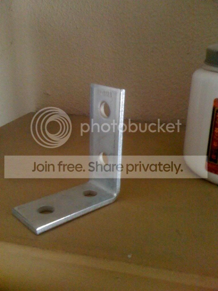

I put my hamster to work, and remembered that I had some 90 deg angle metal bracket, here is a pic:
http://i899.photobucket.com/albums/a...psd5c74b9a.jpg

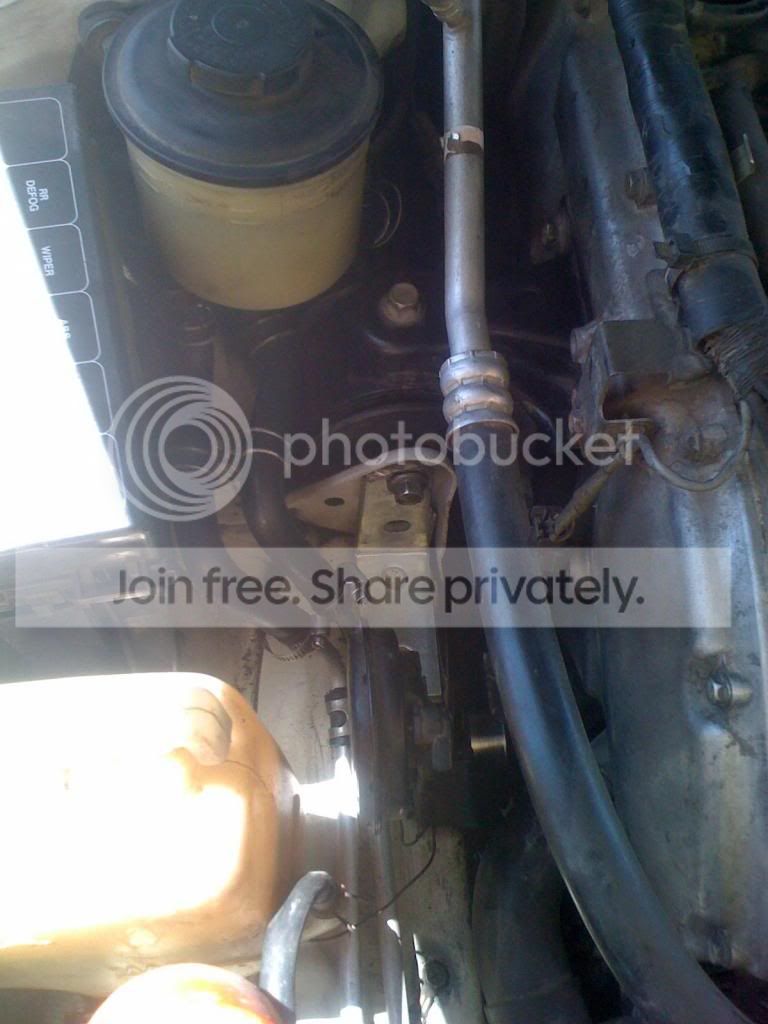

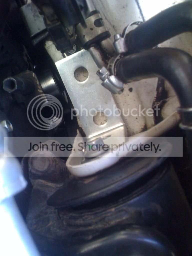

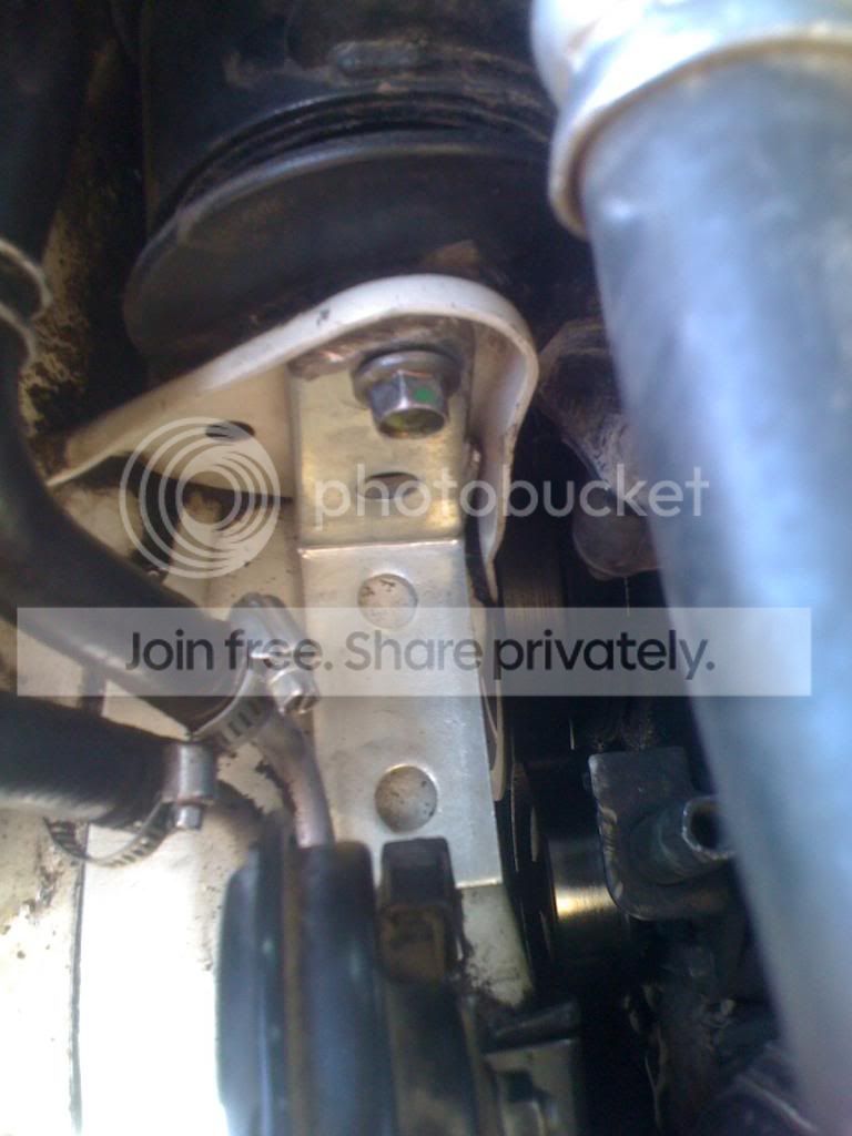

So I thought that it may fit on the pass eng mount with some modifications in order to stiffen it...To my surprise, one of the holes lined up perfectly, I just had to grind/cut some material to fit inside the anchor point, and it fits like this...
http://i899.photobucket.com/albums/a...ps5d821de2.jpg
http://i899.photobucket.com/albums/a...ps504475f8.jpg
http://i899.photobucket.com/albums/a...ps59fa2721.jpg
NOTE: If you are not able to see these 3 pics, go to the first pic web link and navigate forward.
I know it´s not pretty, I know I still need to secure it to the chassis BUT...I gave it a test drive and MAN DOES THIS THING WORKS!!
As I was backing up, I could feel a firmness I wasn´t expecting, as usually, my chassis flex when coasting off my driveway into the street.
I engaged first and the usual jerkiness (You know that our clutch is not smooth engaging, or at least mine is hard to takeoff smoothly) was almost unexistant...Shift into second, and is was a smooth shift as never before...My wife was on the passenger side and also commented that the shift shock wasn´t there.
I drove to open road on a nice flat straight section, and started to drive spiritedly...I can tell you with confidence, that the shift shock or jerkiness thru the gears, was at least ¨softened¨60 %.
I don´t remember how much I paid for these, but it shouldn´t been more that 10 bucks...These metal brackets are sturdy, and I´m sure that guys with welding equipment could fabricate these in no time.
I highly recommend this mod, it´s cheap, and it´s effective.

The thing you braced is the chassis,(unibody) and I highly doubt that did any flexing or it would have snapped off long ago. It's a ridged part, not meant or designed to flex.
The flex is happening inside the mount itself, the center of the rubber section that the bolt goes through. And that mounting point itself isn't really controlling engine movement that much if any at all. The front and rear mounts are what holds the engine from rocking back and forth as torque is applied.

That's what I was about to answer...After the test drive as it was, I felt a difference.
Even when it was not bolted down it fit SNUGLY, I had to push it down with some hammer whacks...Once I placed the bolt of the mount thru it, there was no MOVEMENT AT ALL, since it sits right behind a bracket for the Power steering line.
There is no placebo, I was very skeptical when I took the test drive, but there's only a way to find out right? I'm trying to give something back to the ORG, as I've received a lot of expertise and know-how from it.
The mod is there, I explained you how to do it, it doesn't require much money or time, yet IT IS EFFECTIVE...With all due respect, I don't care if some of you think is ghetto, flimsy (My God, this bracket is more than a quarter of an inch solid steel, no way it would flex), or it's just added weight...It works for me, I wish I have a GoPro camera to shoot the before & after.
Back to track...After posting the thread, I bolted down the bracket to the chassis using a big washer and a self-tap bolt.
This is not the eight wonder, but it sure does help to those who try it...And seeing that NWP is more than 100 bux, I think it's worth a try.

It does stiffen up the anchor point of the pass mount, when installing the mount bolt, I whack it with the hammer and the mount flexed. So it is indeed weak, that's why the torque link, and the torque dampers works...
In other words, it does what the NWP torque link does, period.

Originally Posted by Logan30
Please do that, maybe he would explain better...I mean, I'm no engineer, but I can understand the goal of the NWP and apply it in some alternative way: NWP torque link ties the pass eng mount to the chassis, my ghetto bracket does the same thing...Random location? It is the same anchor point that NWP uses

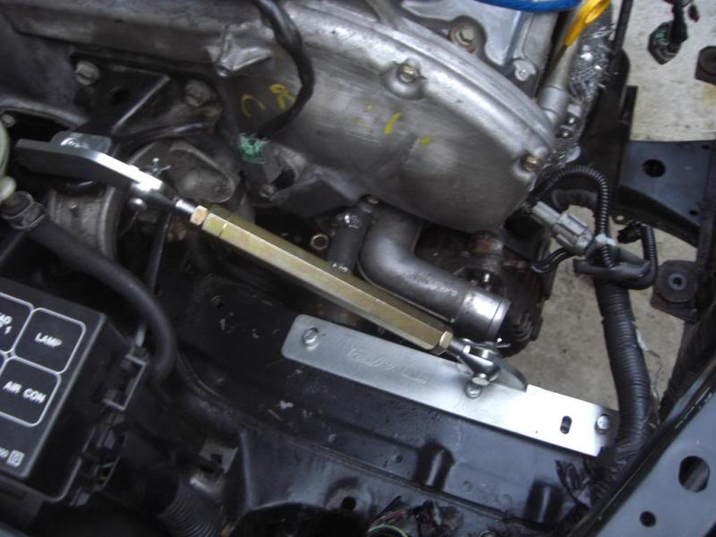

yea ok lets take a look at this here is the NWP mount:
Notice where the link is mounted. Its ontop of the motor mount making it has not yet gone through the portion rubber portion of the motor mount. There is a reason why its located ONTOP of the motor mount and not the bolt that MOUNTS THE MOTOR MOUNT TO THE FRAME wise guy.
Just because its in the same general area does not mean it does the same thing. It is specifically bolted ontop of the mount for a reason.

just curious, how thick is the bracket that the motor mount bolts to...looks to really be only about 1/8" steel that is rolled @ the edges for added strength then welded to the chassis...am i wrong, doesnt apppear to be part of the chassis itself but a thin metal bracket that is welded to it...so if that is the case, in theory, I could see where this could make that bracket a lil stronger

Originally Posted by Crusher103
There is no need to try it you have not done anything to your actual motor mount. Are you listening? It has to be engine to frame, not essentially frame to frame. that flimsy piece of metal has done nothing help the performance of your car accept add weight. This is the same argument people have over strut bars they do nothing its just added weight.
Let me explain this to you so you will understand, unless there is a CRACK between the top of the mount and the frame will this make a difference and if that is the case your car is structurally compromised and extremely unsafe to drive. A decent size bump could cause the front passenger side of your car to collapse. So if it did ACTUALLY make a difference you need to tow that car to a body shop to have it inspected not arguing with us over this stupid flimsy 3" piece of sheet metal you put on your car.
All right, that's your opinion, everybody has one...I'm just letting you guys know my experience with this cheap mod, that's all...No need to get agressive, if you don't like the mod or don't believe it works, that's fine. Hopefully someone will give it a try and back me up with a positive review...We can discuss why it shouldn't work endlessly, I actually did test my theory, and it worked for me, that's my stand, no need to lie or to do a hype over this mod, if you don't try it, you'll never know...
That's right man, the bracket where the pass mount anchors is weak.
assuming that it was fully bolted to the bottom...
it will limit the engine mount bracket from moving. the rubber in the mount would still flex with the engine. the amount that it will limit is a small amount. the fact that he can actually FEEL the difference inside the car is a bit hard to believe.
Thats where you are wrong. I know.
Nobody with 3/4 of a brain is going to back you up on this one, this is just....No. Just no. Its laughable.

I'm looking at the pics and it looks like the OP has the OEM motor mount insert. I don't know how old his mounts are but I can see how it would 'minimize' the engine roll/flex. These things are flimsy when old. To me it doesn't look like a solution...just a way of prolonging the use of OEM inserts. The amount of roll/flex he has can be fixed but just putting in the ES Poly bushing insert

Ok, easy on the OP. And thanks for giving back to the ORG, man. In all seriousness, check out your motor mounts. If they are toast, replacing them will make a big difference in the "movements" you are feeling.
Also, I see how your mod would give support to that side of the motor mount if it was moving. How much support? We wont know without crunching some numbers. The problem with only adding support there is that the area with the weakest link has not been touched. This is the rubber inside of the motor mount. Even if you put another one of your brackets on the firewall side of the motor mount, it hasnt effectively limited any movement that is cause by the rubber inside of the mount.
