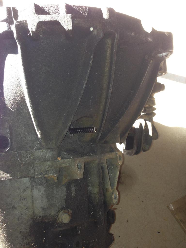

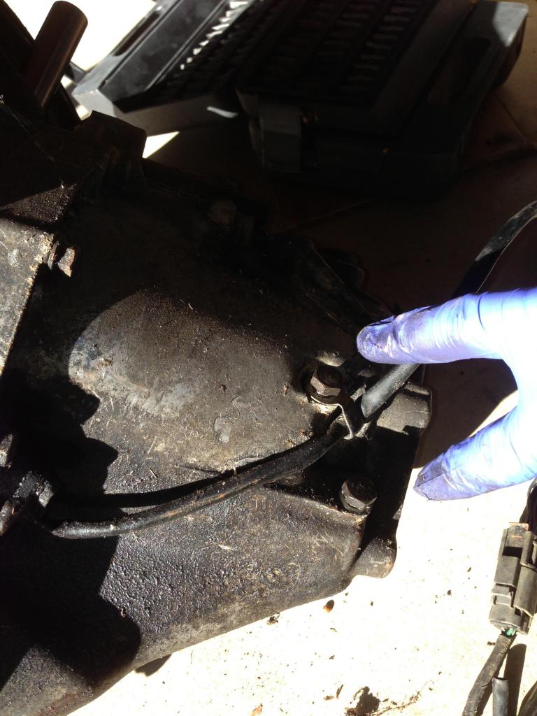

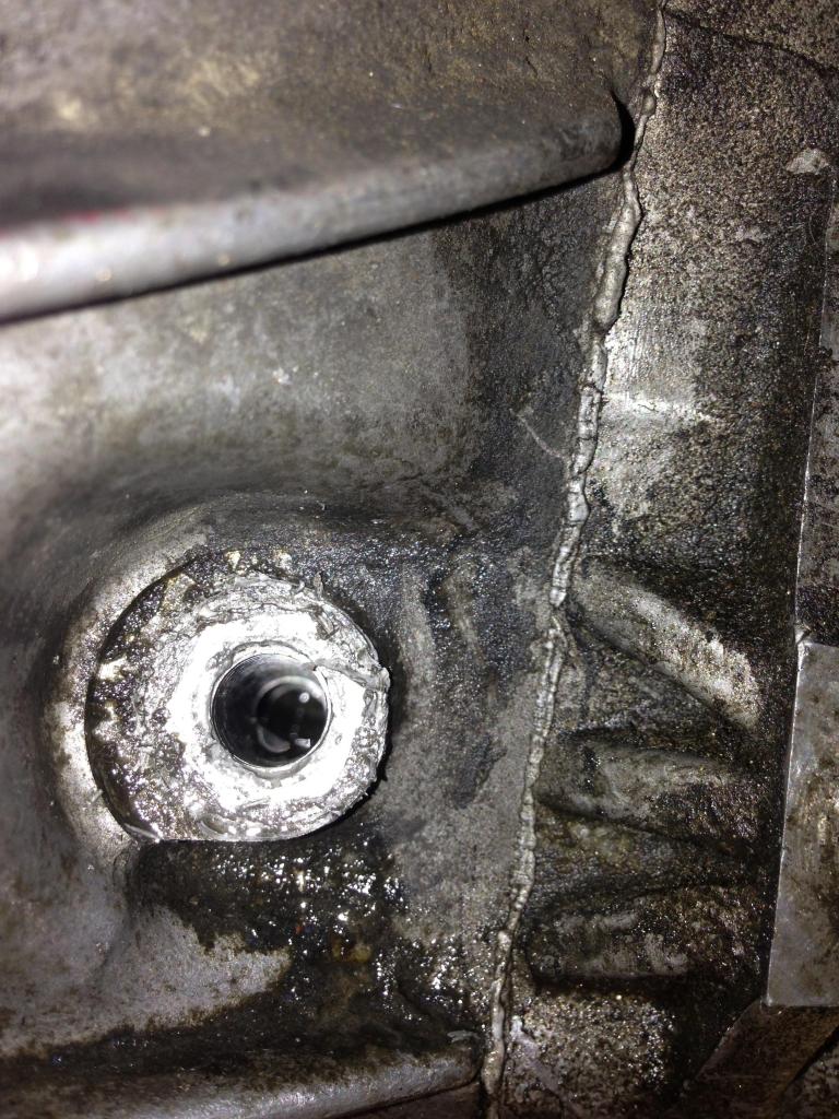

here are a few pictures
This is on one of my extra trans. Both of these bolt/plugs have springs and ***** behind them. They have shorter springs than the other bolt I took out (see below)

Here is the other bolt/plug I took out that also had a spring and ball behind it...again this is on my extra trans, this one is not in the car. I left the spring sticking out of the hole, you have to pull it out, it does not just slide out.

Here is that ^ bolt removed on my trans that is in the car. I have already pulled the spring out and I am trying to take a picture down the hole to see if there is a ball in there.

Anyone who has had issues with this. Am I looking in the correct spot? Is this the correct hole that people have issues with the ball coming dislodged? If so what did you do to fix it?

*Just as an update I was able to get a small enough magnet and put it down the hole I had the longer spring coming out of and I was able to retrieve a ball bearing*
Can anyone confirm that I am looking in the right hole. My next step is going to be unhooking the shifter at the trans and seeing if I can force the trans into reverse with something else (i.e. a screw driver).
