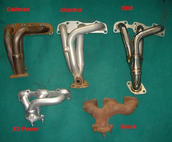

As long as they're longer than OEM's, it's fine. All versions have shown similar gains.
the top 3 would make similar gains, the bottom one, not so much.

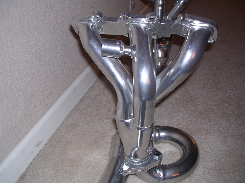

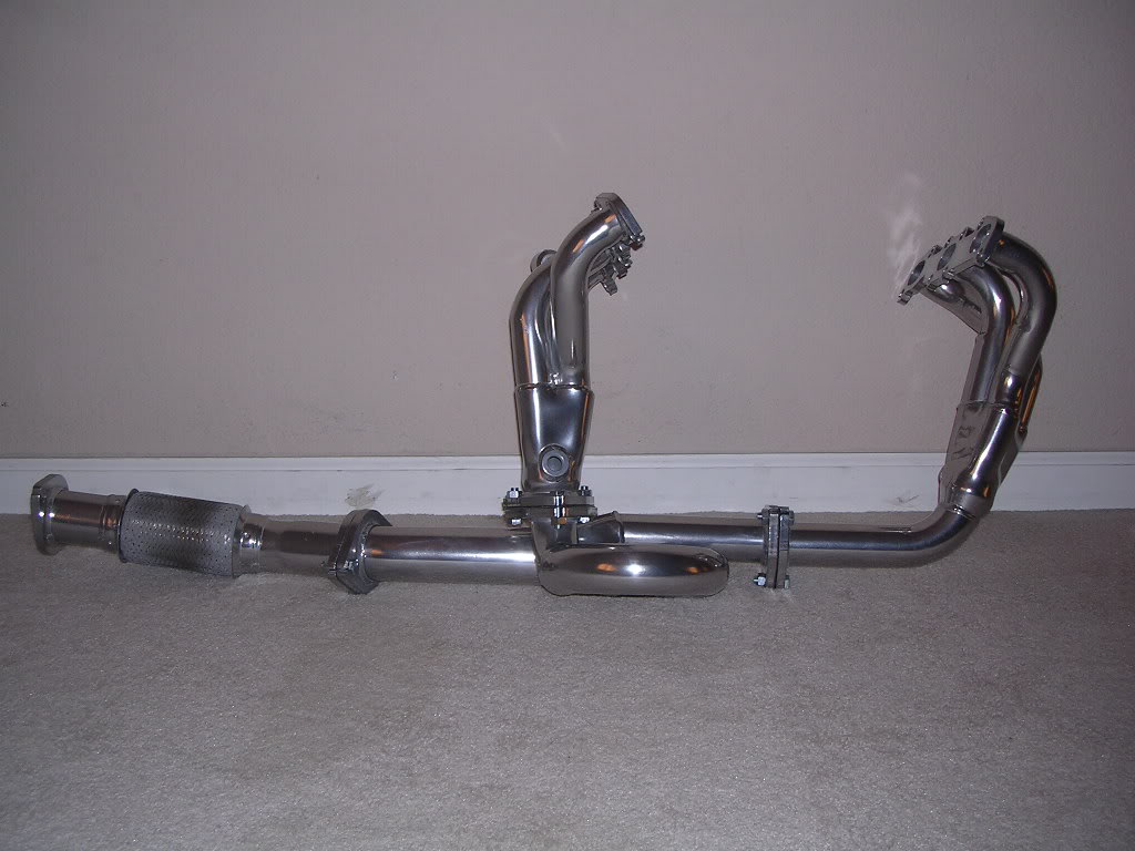

These are my Gen I Cattman's:
No problems as of yet.
