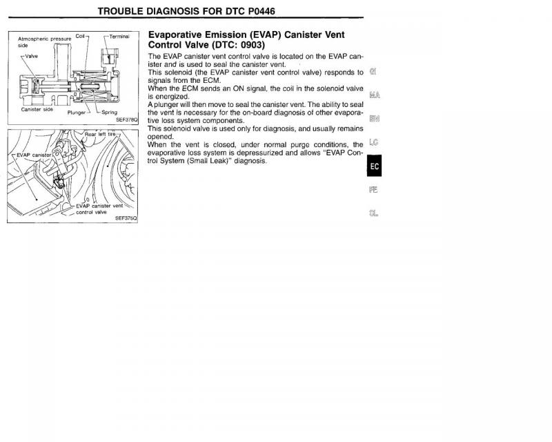

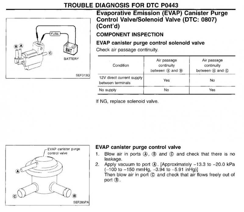

Good for you. Check the fsm instead of what dummies on the net are calling it. The purge valve is on the intake manifold.
