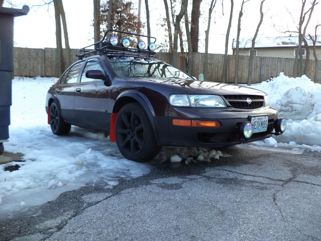

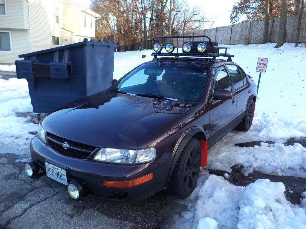

i forgot about this thread , i have been busy the last few weeks i still need bigger tires but this is what i got so far .

How is your car that clean with all that ice on the roads? Here in Texas we had ice for about 4 days and then slush on the roads for another 3 or 4 and mine looks like hell from all that crap.

Nice! Off to a great start!
What are those fender flares?
i washed it the day before.
ebay stainless steel wheel arch trim. they don't really fit it takes alot of work to make them look decent.
link> http://www.ebay.com/itm/251374620478...84.m1497.l2649

ahhh... I've seen those, and had a similar idea but personally didn't feel they were cost effective with having to prep and paint them. You did a great job with it though!
