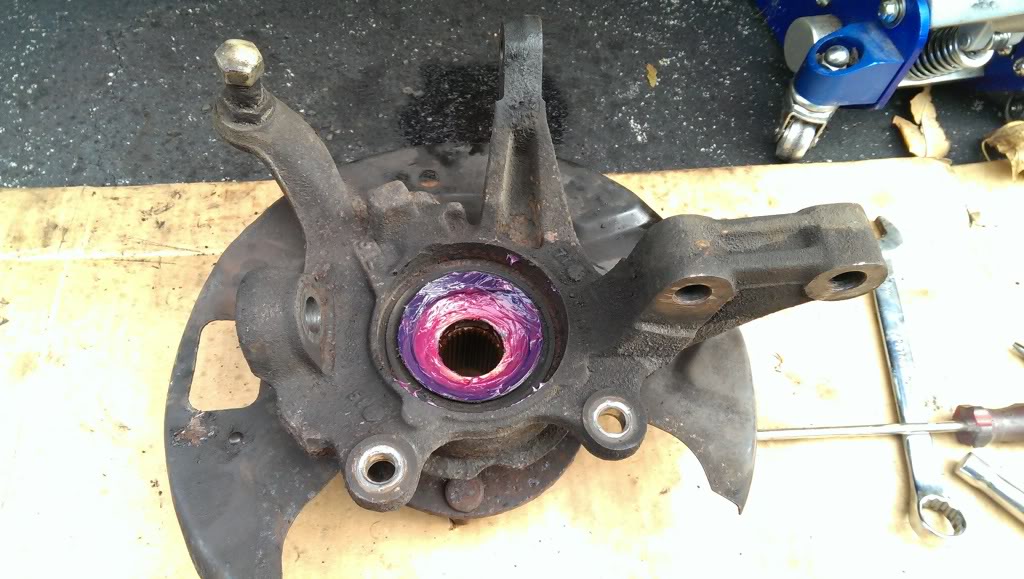

I finally get this thing sorted out, went to junk yard, pulled a spindle with good bearing for $75, took out old one, indeed the bearing was shot. Replacement tooks about an hour and half, I also replaced braking pads on both front left and right. Test driver confirmed that the scratching noise is gone. I do have to buy a 36mm axle nut socket. Alignment is needed?

The bad one I took out

Top one has the bad bearing, bottom one is the $75 junk year spindle:

Grease up before install:

Umm...was all that grease suppose to go there on the back of that hub? I thought the grease was suppose to be inside of the seal...
